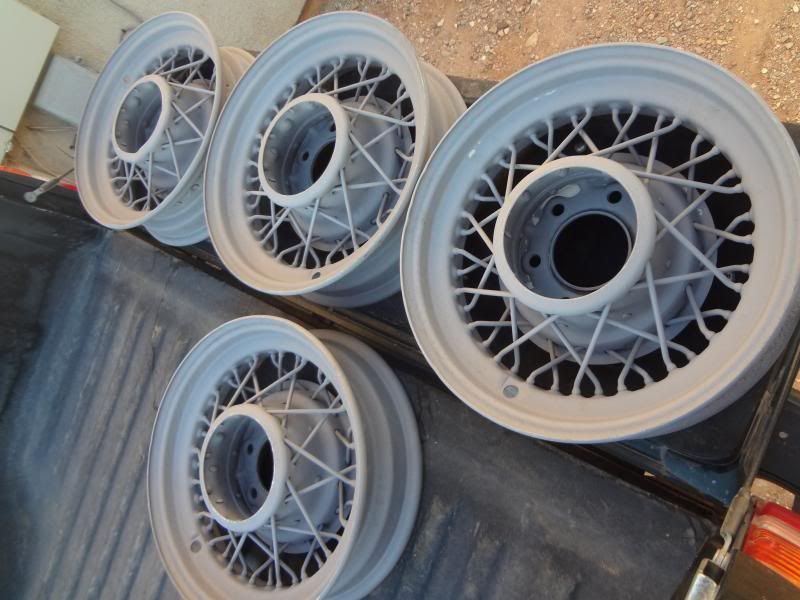

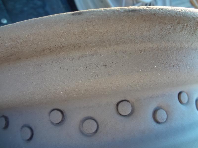

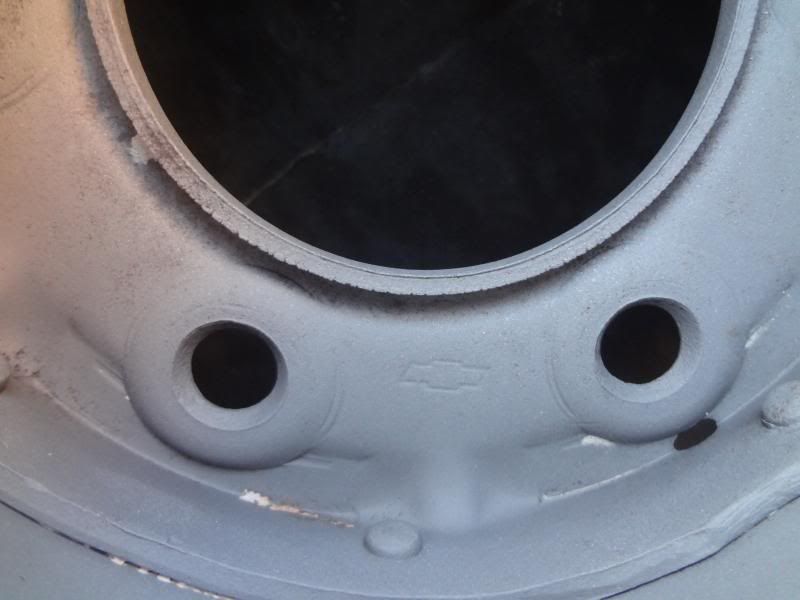

I picked up these wire wires and very little about and can't seem to find a lot of information. They are a 16 x 4.5, 40 spoke, 6 on 5.5 wheel and have a bowtie stamp in the inner hub face. They are not adjustable. Three are in good shape and the fourth has a little ding on the lip and across the hub cap face. These pictures were taken after I sandblasted them.
What are they worth? Can they be trued and to what value....060"? Any recommendations for guys that can true these up? Any thoughts to the year?

I believe they are an accessory wheel , but I cant give you the specific year, but would suit many of the 1930's vehicles , letting them use 16 inch diameter wheels.

The 1931-32- 33 wheel has a hubcap opening diameter of 5 3/4" so that will tell you if that hubcap will fit these wheels.

From the photos your wheels look like pre 1934, as the '34 hubs were larger, so the center opening would be larger than your photo shows. The chrome spokes were likely a slip on cover design.

1934 1935 Chevrolet standard series were 5 lug with 4 3/4 bolt circle and have a rim size of 17 inches.
They must be for trucks after 1935 ???? that's my guess.

4-1/4 bolt circle Mike...Joe

I have 5 of those wheels that were made up by early hot rod builders. They would take the earlier Chevrolet or Ford wheels of 18 or 19 inch and cut the spokes and bend them and put 16 inch rims on them and then weld each spoke to the new rim one at a time. A neighbor that lived next door to us has a jig that he done this with. He made only Ford the wheels. This was in the early 50's. I also seen a pair of the factory made wheels like the ones in the picture on a box type trailer at the City of Tucson water department. The ones I have my Dad got them with a box trailer he traded for. It had 4 with it and I found another one at a swap meet. They look like they will only fit the 1930 to 1933 models but not the standards. I am also from Tucson so that is odd that there 2 sets of similar wheels. Chuick
