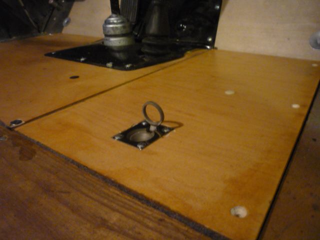

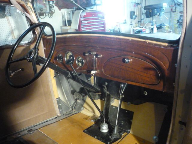

Hi Einar, here's mine. I copied the floorboards from my parts car. No telling if they were replaced. The battery side was missing so I made one up to fit. It may have been fixed with a steel insert.

Thanks for the pictures Pat. Since you took the pattern from your parts car, can you tell me how the floor board opening is cut around the shifter and handbrake . What I want to know is the cutout area open all the way to the to board so it will slide in or is the part that meets the toe board one solid piece?

Here you go. This was before I realized that the toe board goes to the bottom with the floor board against it. Compare this with yesterday's photo.

Pat, Thanks a lot that is exactly what I needed to know.
