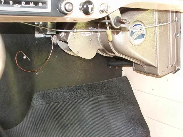

To remove the brown handles from the door just expand the slot you see in the second picture with a small screw driver. At the same time you expand the slot pull on the handle. It comes right out. Just another simple engineering marvel. Good luck, Mike
