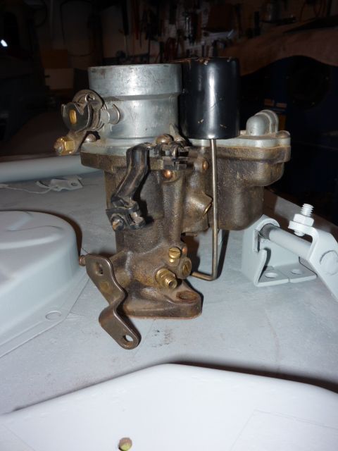

Chipper,if I sent it to you, could you tell if it has incorrect parts?
Pat S Offline OP
I also have this one which is, I believe, a factory supplied replacement for the other one.
Yes,

Pat, the carburetor pictured is a later model ca. 1941-48. Has the double bend accelerator arm that fits '37 and later. '36 and earlier use straight arm.
Pat S Offline OP
Chipper, assuming we eventually narrow it down to the carb and I want to change it, would the arm or arm/shaft combination be interchangeable? It actually was on the engine I bought that was in this coach.
It can be made to work but, be cautious about interference and potential sticking of linkage.
