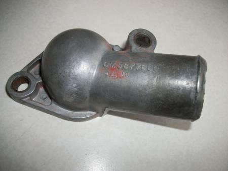

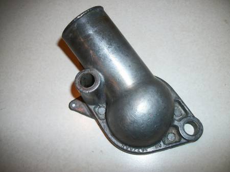

I'm trying to figure out which water outlet is correct for a 1967 Camaro 327. I see two types advertised regularly. One with the P/N on the base flange and one with the P/N on the neck. Both have the same P/N - 3877660, which is what the book shows as being correct. Is one style correct for 1967? See pictures below.

The top picture with the small tab for the carburetor throttle return spring is correct for 1966 283's. I do not know when Chevy changed the style like shown in the lower picture.

The water outlet in the lower picture also has the throttle return spring tab. The only difference appears to be the location of the P/N
