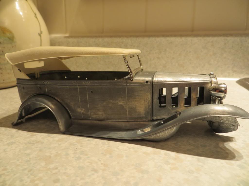

The first step was disassembly. They are held together with lots of little screws and glue. I really got lucky, as the builder had used a hot glue gun for glue! All of the glue came undone as I was stripping the paint, and washing the body in hot water. The body and fenders went into the stripper bag for 5 hours. I use Pinesol cleaner... it takes the paint right off. I used a toothbrush, scribe and hobby knife to clean up what the stripper missed. I really think these kits look beautiful in bare metal... like they are fresh from the miniature Chevrolet factory!
Here it is in the stripper...
Here's what there is to clean with the scribe, knife, and a toothbrush after it comes out if the bag...
And here is the cleaned up body in bare metal...

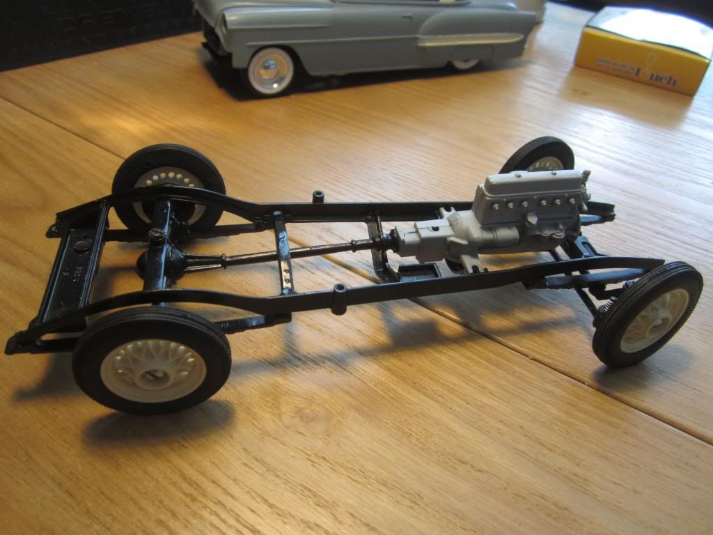

I also got the frame and suspension ready for priming and paint...

Chassis all painted up! Wheels done in Model Master Light Ivory. The fenders are primed, and ready for Tamiya Gloss Black.

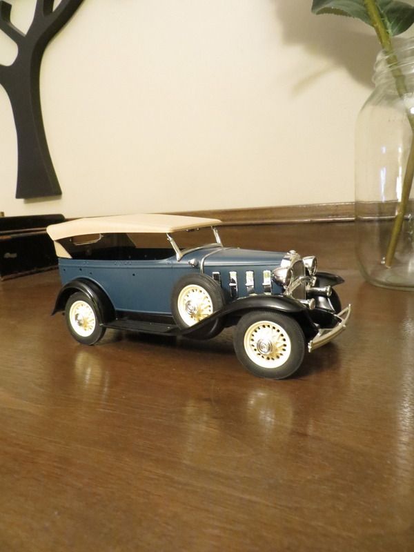

It's been a while since I was at the hobby table… but I did lay down a new paint job on my phaeton. Tamyia black fenders and US Naval Blue for the body. Still a lot of detail work to go!

Beautiful.... Really Beautiful. yay

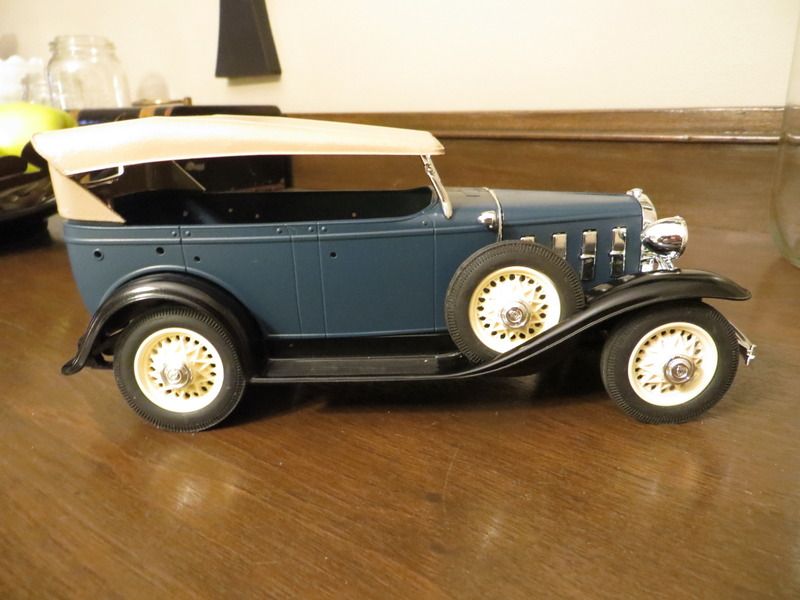

Looking great! So are the tires narrow for the wheel wells? If they are then that one is a Ertl model made in the 90's I have them and stopped when I got the real thing!

Bruce, This is a Hubley from the 1960's. It's 1:20 scale, so is a bit bigger than a regular 1:24 scale Model. I think those Ertl ones were even smaller, like 1:32...

So after Hubley went out of business another model maker got the molds for the 32's at least. You will find some with that name on them. Then in the late 80's early 90's ertl got the molds and made them again. The only difference that I know of is the tires are narrower on the later models. I have the ones which my dad made and my later ones. I'll get some pictures when I get home.

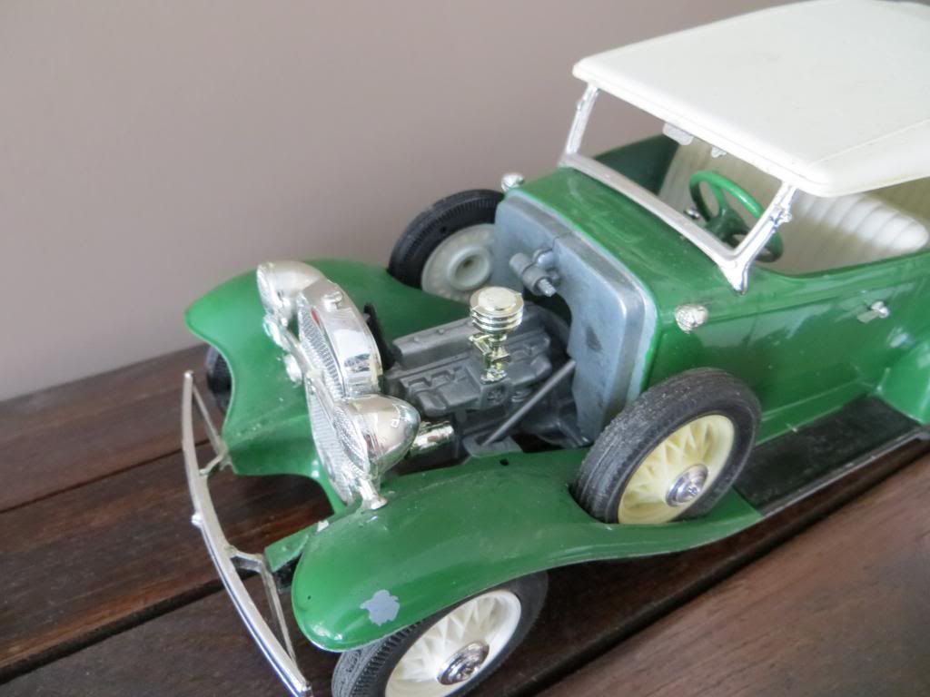

Added a bit of front end chrome today. I don't know what I'm going to do about the head light lenses, as they do not come with clear parts. On my roadster I used Jo-han 1931 Cadillac lenses, but I don't have any more. I'll have to work something out, as I hate the chrome ones that come in this kit.

Was thinking perspex for the lens's .. Dremell to shape up and run a heat gun on them to clear finish..
