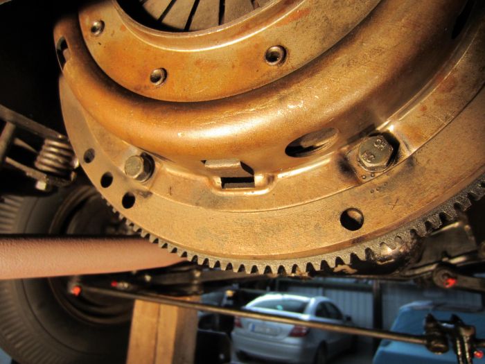

Today i removed my clutch. Sometimes I wonder which ”žTop Mechanics“ work on the car. When there are four marks, in this case “x” and “0”, than It makes sense, when they fit by reassembling, or not? See this, completely wrong.
Picture 1-3

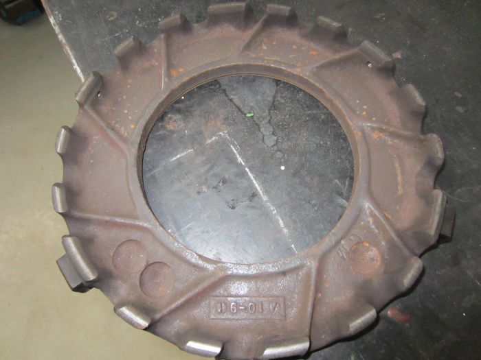

What do you think about the Condition from Pressure Plate and Clutch Disc?
Picture 6-9

Its hard to tell from a photo, but the clutch pressure plate appears grooved. The best repair would be to resurface the flywheel and replace the clutch disc and pressure plate. If that is not feasible then I would resurface both flywheel and pressure plate surfaces and replace the disc or possibly have the disc relined.

The only things that I see that are questionable are the pilot bearing and (unseen) the clutch release (throw-out bearing). I would replace both of those. The pressure plate looks okay. If you are going with a new disc then I would have it planed. Otherwise not, after all, the same disc is going to mate with the same pressure plate surfaces.
The clutch diaphragm spring looks a slightly grooved where the release bearing has rubbed it over time. The spring looks fine and it should be okay.
Go with a new pilot bushing instead of the old roller bearing.
Go with a new (no matter what) clutch release bearing. I can get you a new one from Advance Auto parts for about 30 bucks. Let me know and I can throw it in with the next package.
If the clutch was not slipping before the tear-down then I wouldn't worry about the major parts in it too much. I also could send you the used synchronizer from the donor transmission as well. It appears to be good.

@ steve 6 - The pressure plate isn´t grooved, as you say, it´s difficult to see on the photo.
