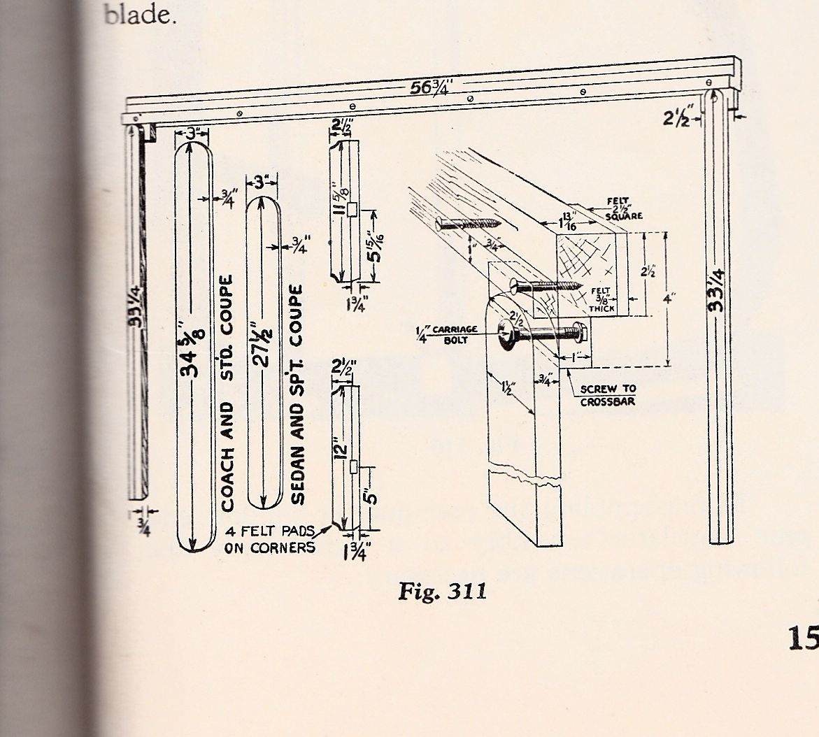

1- When the time comes to install the garnish molding, how important is it to use this tool?
