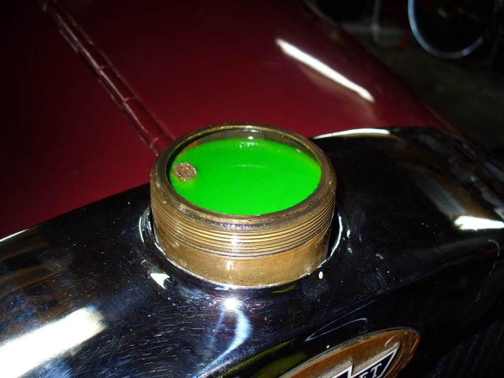

I use modern coolant in my 28, and run a low pressure sealed system with an overflow tank, have done so since the 80's. No problems, no corrosion, no rust, near enough no water useage.
Dare to try something different, you may just find it works for you.
Cheers
Ray

I agree Chev Nut,
Green for me, since the 80's,and I change it about every 12 months.
[Linked Image from i1091.photobucket.com]
Cheers
Ray

Coolants in OZ have Anti Freeze capabilities, but they are rarely required. Our main needs are anti corrosive and in some areas lowering the boiling point.
Most of our moderns run either the red or orange, and the older cars the green. In the case of the Red Chev, the Nulon long life green coolant I use keeps a nice low sheen on the brass impellor on my water pump, and a gun metal bluey grey on the inside of the engine block.
I did try water soluable oil back in the late 70's, worked fine except it softened the radiator hoses and I had to replace them every 12 months.
The modern green coolant does not cause any dramas with rubber..
After experimenting with the standard mixtures, which range from 30/70 to 50/50 for severe applications such as trucks etc, I settled on 70% coolant/30% water, which works very well in the chev 4 engine.
This is the coolant I have been using for many years.
http://www.nulon.com.au/products/Cooling_Systems/Long_Life_Concentrated_Coolant/
This coolant should not be used on a standard (open) Chev 4 cooling system. I run a low pressure cooling system, with an overflow tank.
Cheers
Ray
