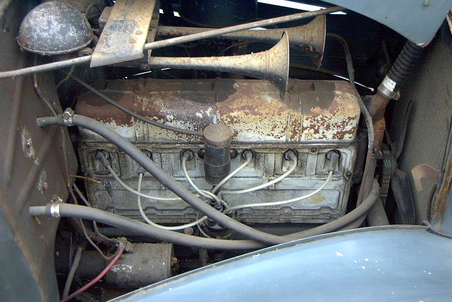

More pics for those who dig 'em
[Linked Image from i1257.photobucket.com]

WOW - An accessory banjo steering wheel. Thats worth a few bucks. And accessory dual horns. All the accessory stuff on the dash and no radio. Kinda of strange.
Its a later 1936 as it has the ribbed valve cover. Good indication that is has the all steel dors used in late 1936 Standards. The steel doors didn't sag like the heavy wood doors did, especially in a 2 door model.

Several good points....the steering wheel is really neat. And the horns are cool.

Very nice looking car. Be careful of mice manure & urine. It has a life span of 30 days. It can make you sick. Wear a breather. Moth balls will keep the mice out. Look behind the horns to see a plate on the firewall. First line has: Body no. (year) 36 (model series) 12 (body type) 11; If the second line, Body No. ends with a "Z" it has the new "Safety" steel doors and also comes with steel door post. Third line has: Trim No. 50 (trim design and material) Forth line has: Paint No. 196 (Navy bluish on mine) color combo. Other numbers like 3FC50718 may be found. 3 is St. Louis, 05 is May and 50718 is the production no. The carpet in front is standard for a Town Sedan. My car is exactly like yours. Good Luck!!!
