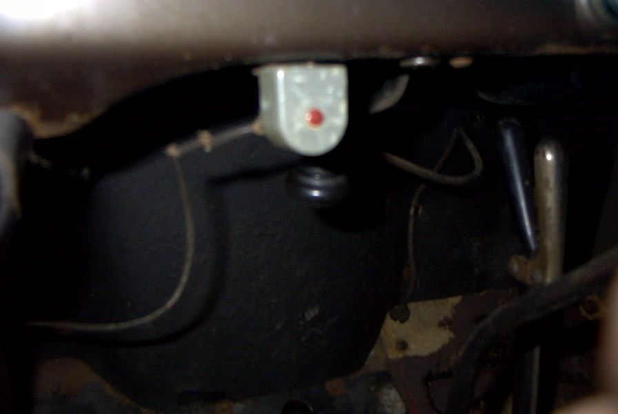

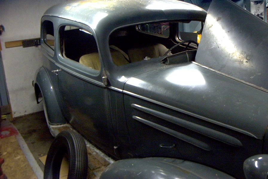

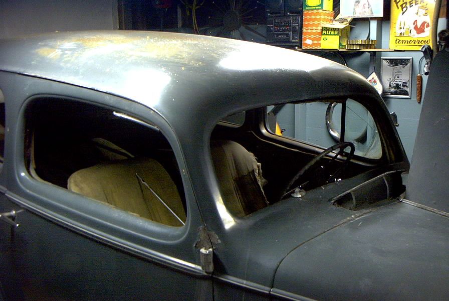

Ugly discoveries today!
I knew the transmission mount was bad but it was worse than expected. Turns out the two studs holes are stripped out from being loose and slamming around for years. The tranny tail will have to come off and a new one found... or maybe have an insert threaded in if its cheaper than locating a used part.
Found some bad rust in the lower door so i'll have to attend to that also with a patch...

A few current pics... That front window did NOT want to come out, the rubber had turned to glue after all these years.
The last under the dash pic shows a little light up thing made out of the same grey swirl plastic as the steering wheel. I traced the wire through the firewall and then down under the cab a ways but lost it. I'm thinking hi/low beam indicator?

Looks like your removing more than just the windshield...What's up with that...?
That wouldn't be the original color showing thru on the roof, would it...?

All the glass has to come out, its all cracked or delaminated badly... The doors need help, the vent windows are froze up as well as the locking/latch mechanisms being almost non working. The goal is to save as much of the car as possible in its present condition. Moldy fabric, rotten metal, or peeling paint has to go. A lot of stuff should clean up really good with a little elbow grease... i'll bet the dash will sparkle with a good cleaning and polish!
There is no remaining original color anywhere on the outside of the body i've found, the shine is from the lights above. Whoever repainted the car either stripped the original paint off or it was gone before they did it. I've poked down through the paint and found a layer of white primer and under that steel. The deeper I dig the more i'm sure this car had an exterior cosmetic resto a number of years ago. In protected places like the firewall I find the original frosty green paint with red primer underneath. Since the original finish is long gone outside i'll be stripping it and repainting it... I guess somebody else didn't like frosty green either... lol!

Did you figure out what your light is for yet?

It runs down to the hi/low switch on the floor... it was a high beam indicator!

Nice looking car! That tire looks familiar tooo

I'll bet it does... i've got a few more floating around bana2
