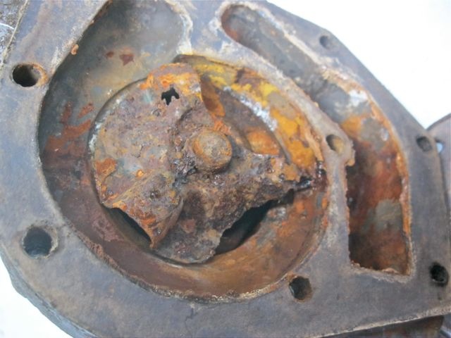

Right.... Fix the correct problem, don't look for a miracle in a bottle. I wouldn't use seafoam, but it has many followers.
If the temp is high at idle, but goes down on driving it, there is a fan/air circulation problem likely. I've seen them full of flies and mud. Could also be internal, that a good flush/seal can handle. The insides of the blocks and passageways get clogged or rusted out. Here is an example of what it could look like inside.
[Linked Image from widman.biz]
I don't think Chevrolet used any water pumps this cheap, but even the good ones could be rusty or have cavitation of the the fins.
Finally, with a $30 laser temperature gun you can check the radiator for hot or cold spots.
On timing, you basically want the most advanced possible without pinging. Living in the mountains, on non computer cars I often have to adjust several times a day. I first set my timing at my office and it was perfect, but It would ping at home (15 miles/600 feet lower). So I had to set it for home (about 5700 ft above sea level. When I used to drive my C20 back and forth from 400 ft to 14,000 ft, I'd stop regularly to advance or retard. Advance is in the direction of the vacuum control.
