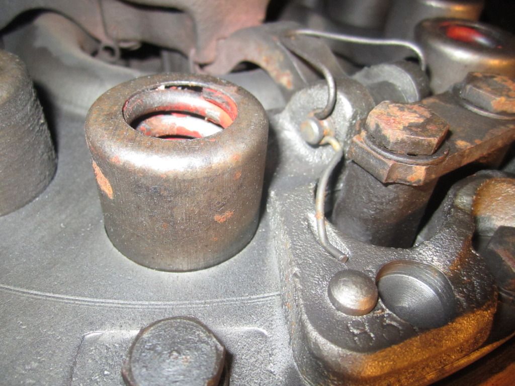

In my pursuit to be sure that my '37MD "black car" is road worthy I had discovered during adjusting the clutch that the fork and pivot ball were worn and I was able to purchase these parts.
My next problem I'm hoping someone here can help me with. Below are pics of a spring wire that does double duty in the clutch assembly.....
Below is a pic of where it is located on the clutch...........
My problem is I need one or a complete set (prefer a set). i found that one of them was broken in half. One half in the inspection cover the other have was still locked on the pivot pin of the clutch finger.
I did find a company when I googled the part, but the company hasn't notified me if they have any in stock.
I'm hoping someone here can help me or lead me in the right direction.
In advance..... Thank you all for any help you can offer.

Contact bwbugay@aol.com he will have the part
The 1937 had a coil spring pressure plate. The 1938 changed to a diaphragm type spring pressure plate.The broken spring is part # 837558 and fits 1934-1937.

Thank you guy's,
The '38 clutch is different from the '37. It just so happens that my '37 MD "white car" has a '38 clutch in it and so was not able to "borrow" parts to keep the "black car" moving forward.
The p/n that Chevegene posted is the p/n that I am searching for. The company I found is called D&D Antique Auto Parts out of Alabama. He has bought up NOS parts from closed dealerships and sells them part time so i know it may take a while before I hear from him.
I'm going to check Tim's posting and see if he has what I need.
I knew you guy's would come thru. Thanks again !

Hi Tim,
Thank you for the lead. Bruce replied and said he only had one left and that it is a used one. I'm going to purchase it so I can move the car and continue to look for new ones.
