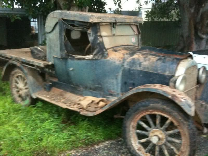

This is a car I almost picked up at the end of last year, I just missed out on the bidding. It sold for about $7000, It had been sitting in a shed here in South Australia since the 70s. I think it was a 27 or 28 Dodge Buckboard
