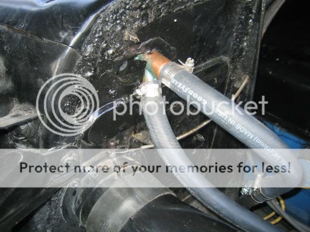

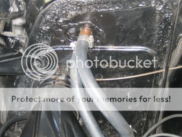

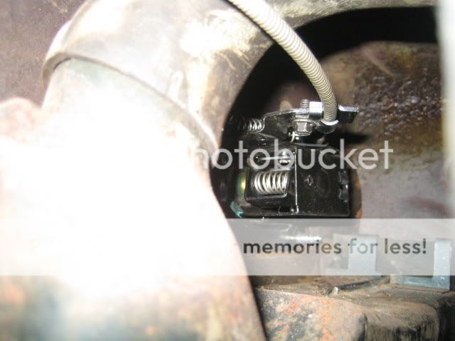

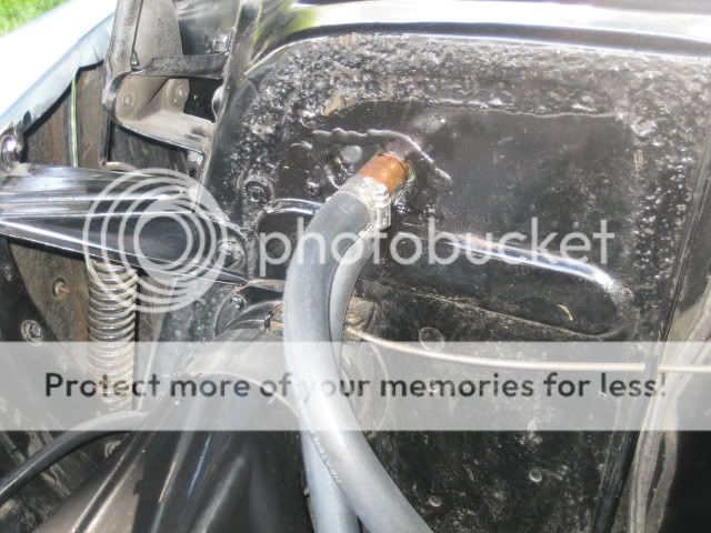

Finally took some pictures of the valve installed....hard to tell the difference.
[Linked Image from i905.photobucket.com]
[Linked Image from i905.photobucket.com] [Linked Image from i905.photobucket.com] [Linked Image from i905.photobucket.com] [Linked Image from i905.photobucket.com]
