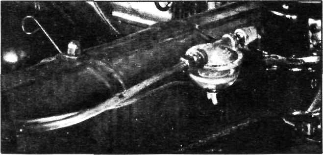

Might be worth an ebay search to find a correct filter for your '47. I looked at reproduction AC filters for my '54 3100 and learned, as noted above, that the AC badge was not on filters until after 1956. So I bought a correct Durex Moraine filter on ebay.
The GM fuel filter accessory that Chevy sold for your '47 was probably a #986128 Durex. Shallow glass bowl with thumbscrew bolt though the bowl.
[Linked Image from chevy.oldcarmanualproject.com]
I have only seen one shallow bowl Durex #986128 on ebay. I recently found it on ebay for a friend's '48 truck. Only $35 and it looked perfect ... body, bowl, thumb screw, and metal filter element.
< EBAY ITEM #300638610178 >
If the ebay link above doesn't work, search for item #300638610178.
