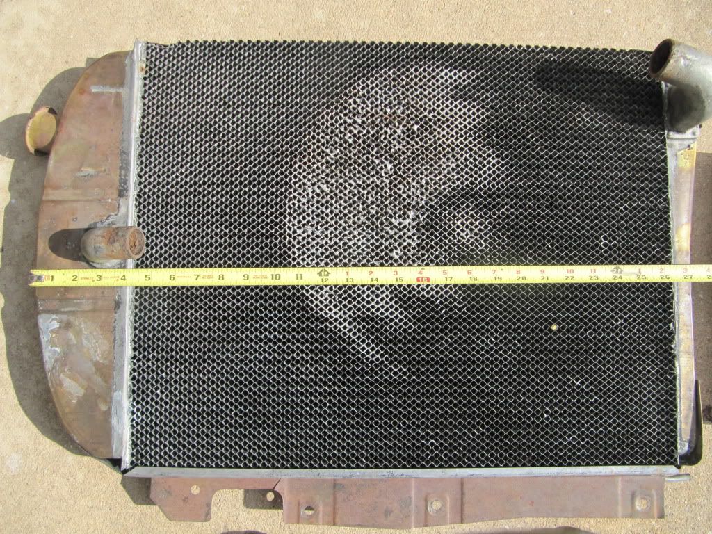

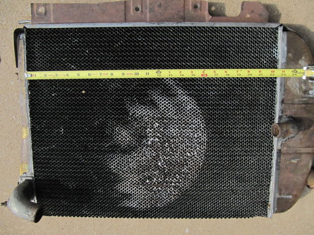

I am not sure of the size difference between a 1937 car and pickup radiator. I have attached links to three photos with measurements. The core is 2" thick. The right side mounting bracket is detached, but I do have it. I did locate a radiator manufacturer who will build a new aluminum radiator that replicates the 1937 Chevy pickup radiator for $350.00 plus shipping. I would still like to use original parts, but may have to go with new for now.
Doc
Hope these work
http://i1144.photobucket.com/albums/o499/tnadams/1937%20Chevy%20PU%20Radiator/IMG_6611.jpg
http://i1144.photobucket.com/albums/o499/tnadams/1937%20Chevy%20PU%20Radiator/IMG_6610.jpg
http://i1144.photobucket.com/albums/o499/tnadams/1937%20Chevy%20PU%20Radiator/IMG_6609.jpg
