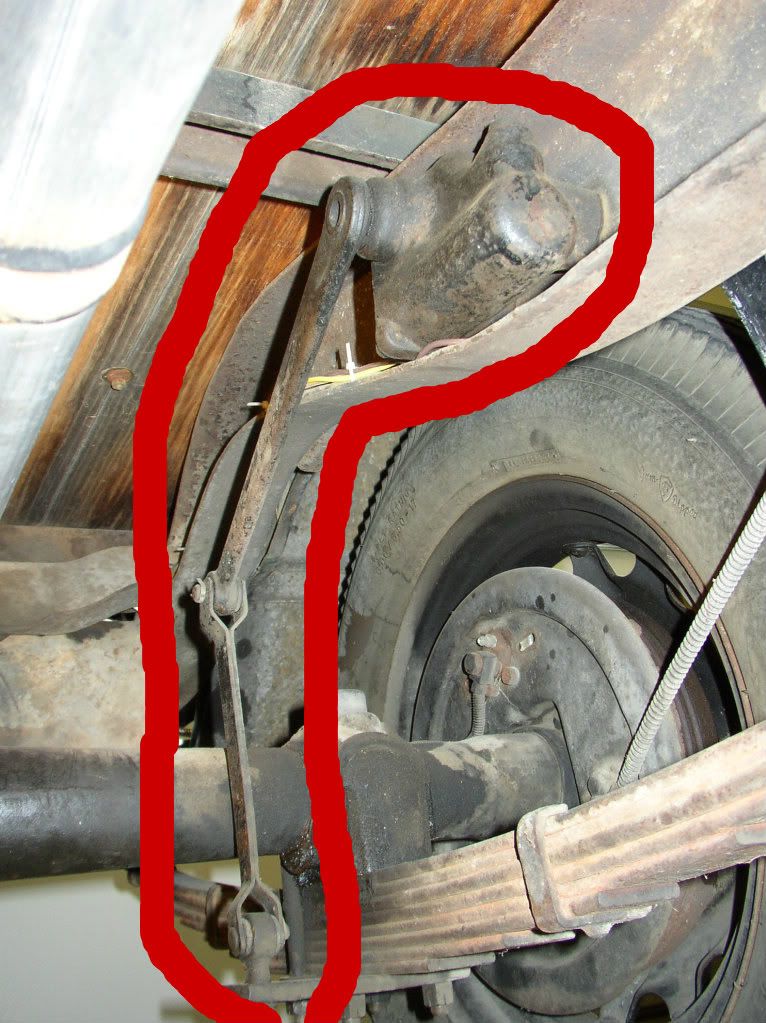

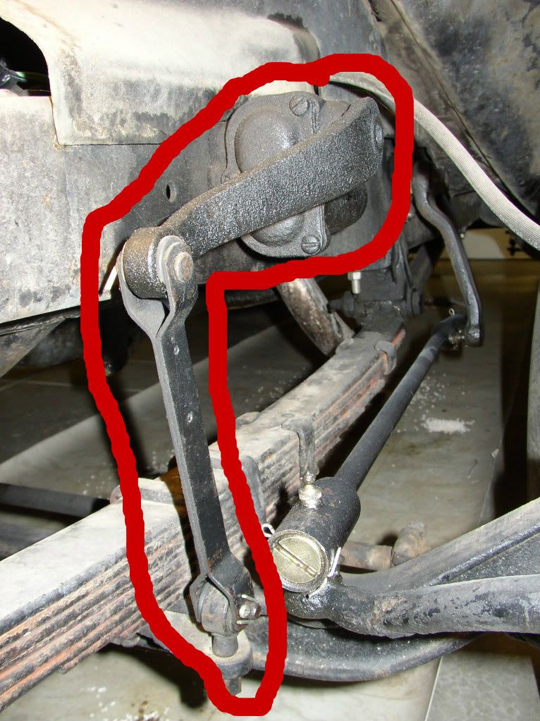

I suspect that you have shocks, but are not recognizing them, as they are not tubular. Here are photos of the left front and left rear shocks on my '36 FB--they look like old-style commercial door closers! The front mounts on the outside of the frame rail, and the rear mounts on the inside of the frame rail. The shock bodies contain light "jack oil" which dampens the movement of the attached arms, which are, through an "elbow" joint, connected to the leaf springs and axles. Hope this helps. ---Wally
Left Front:
[Linked Image from i292.photobucket.com]
Left Rear:

i can see how they could bolt on the frame but there are no brackets on the front or back of this truck for the lower arm of the shock to bolt to.and there are deffinatly no shocks present.
