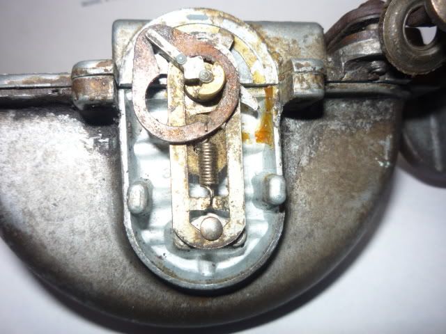

I had looked into mine to possibly overhaul it and found the reversing mechanism parts were all loose in their cover. A posting here had given me a go to place. I have sent him a photo of my motor asking for a quatation or a NOS motor. He more or less told me that opriginal '34 motors were almost always warped and weren't worth the effort.

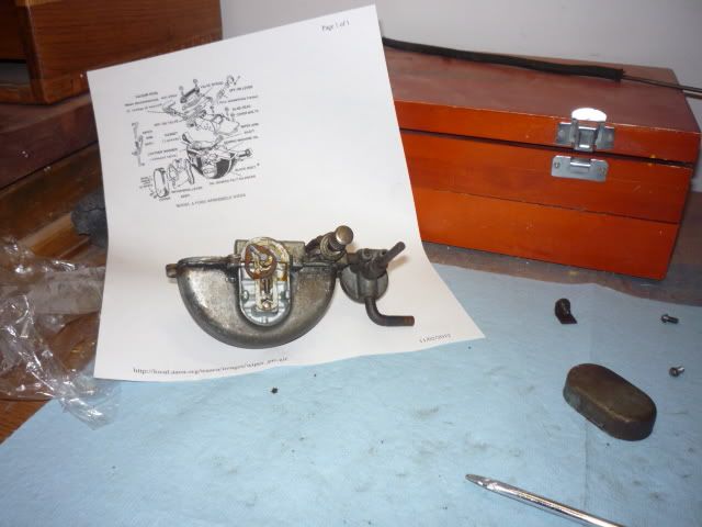

So I found a diagram on the internet which allowed me to put the parts back the way they belong. Now I'd like some suggestions on how to clean all this. Soapy water, lacquer thinner, CLR, Oxy-Solv, brake cleaner or whatever? Is the sweep pad leather or rubber? pineapple

I managed to save the gasket. I'll clean it up, add oil, (the drawing I found suggests sewing machine oil), but I can see a hydraulic fluid like ATF would work.

Here's the link: http://local.aaca.org/traaca/images/wiper_pic.gif
It doesn't have the thing with the knurled rod . As far as a source The Wiperman appears to be the main one.

I put the grease in & went back to the truck It seems to work only in one direction. When I pull the on/off it goes about 1/4 turn and stops. When you push it back, it goes back to where it was. The hissing sound seems to come from that speed control.

Tried it without the speed control and it does the same thing. The hissing sound is still there and appears to come from the on/off control. Maybe some of those little galleries underneath the slider are plugged.

Are you sure that you have the switch parts properly assembled? The side of the plate with the holes goes down and the spring forces the plate down against the cover. Don't remember if the plate needs to be installed a specific way. If so try turning it around to see if it works better. You will get a swish sound from the valve if the motor is working well or if the switch plate is not installed correctly or a passage is blocked.
Pat S Offline OP
Holes are down, the other little plate rests on a soft pad and is hooked to the center of the bottom plate by tabs, then the spring, then the push/pull lever.
I'll try poking inside the little holes.
