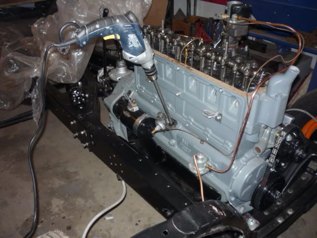

Put some oil in the pan and drive the oil pump with an electric drill at least until oil shows at the rocker gear, line it all up for #1 and fit the distributor. Then try cranking it without spark plugs, all theories being correct you should have compression.

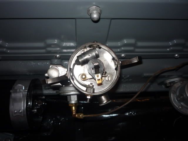

Oil is in. Took off valve cover and verified #1. Seems to be OK. Installed distributor. Does that look about right for #1. Does one make a special shaft to prime the oil system with a drill?

Looks like It may be slightly off of # 1. Can you pull It up and rotate the rotor tab to the 7 oclock position? A screwdriver shank makes a good tool to insert into a drill to spin the oil pump.

I turned the engine over to bring the piston up and the rotor ended up near & o'clock. I was at the bottom of the compression stroke I guess.

Did that. The oil came up in the front rocker assembly only. Took the centre part off and looked for blockage. I might have had it backwards. It now comes up in front too. It didn't squirt as Mr Mack had suggested though. Looks like the front is getting more oil. After having done that I hooked up the 12V battery from the Mustang. It turns the engine but rather slowly. Only got 30 lbs. on the compression gauge. Either it is still turning too slow or I did put the cam in wrong. Any ideas?

I think you meant at the 7 oclock position and not &, since they are the same key? Yes, you must of been at the top of the exhaust stroke, thus the exhaust valve was closed at this point. Do you see the round ball timing mark on the flywheel that will verify that it is in the proper postion?

Pat, If your engine is like mine, when It was freshly rebuilt, It will be tight and even 12 volts will spin It slowly, plus It will want to overheat fairly quickly. After a few hundred miles It will spin over alot faster, even on 6 volts, and will run cooler. If you are on TDC with both valves closed and can see the timing mark you are set up correctly.

When turning an engine that has been freshly built, remove the spark plugs, insure you have primed it with the drill, and then 'jump' the starter by connecting directly to the starter and the bell housing. The best tool for 'jumping' is a 12-volt battery pack. You can safely make your connections and use the switch on the pack to turn the engine. Continue to turn the engine watching the heat of the starter. When it is hot, stop and let it cool. When turning the engine you should be able to observe the oil fed to the rocker arms.
