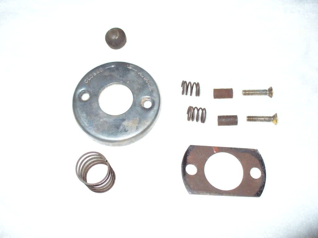

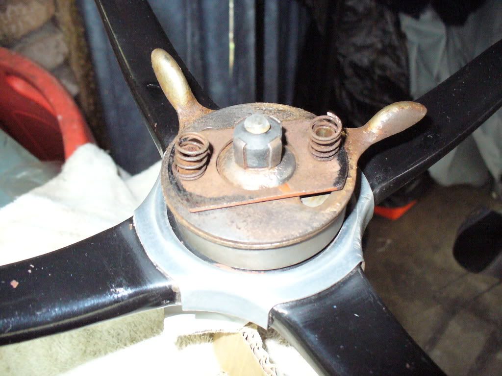

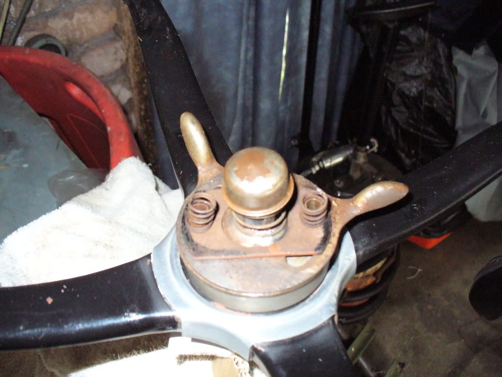

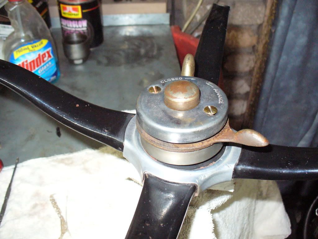

there is something else ray the horn button on the stering wheel i have the button but not the contact ring behind the button would they have that
The '27-'28 horn button contacts the end of the wire extending down the center of the steering column to complete the ground. There are a couple of springs and tubular spacers in addition to the disc with three holes (apparently the part you are missing).

Hi Tiny,
I will send you a picture in the next day or so of the horn assembly, so you can identify what you are missing.

Hi Tiny 64,
A few photos of the components below. Let me know if you require further detail on how they fit together.
