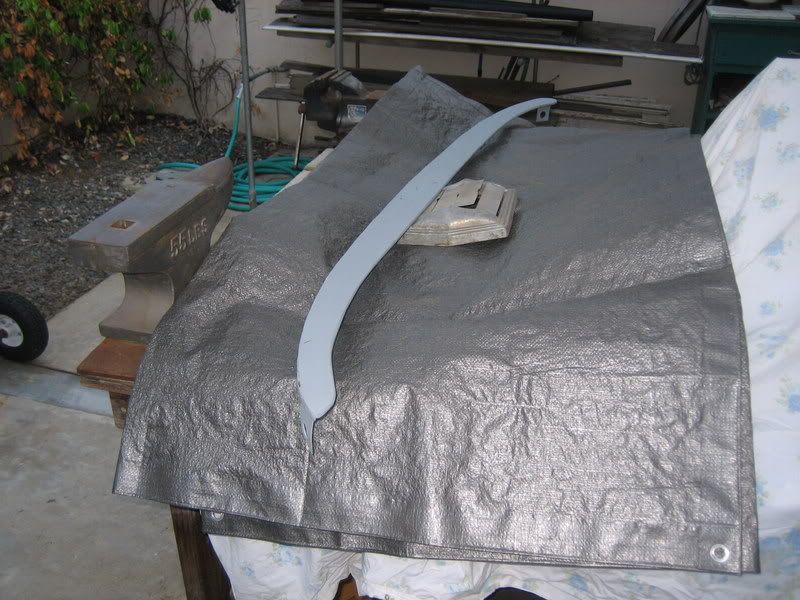

I got the rear gravel guard that I had made. Does anyone have a good picture of one on a 38 or 39 it sure would help me check it out. My car is still on a rotisserie
Thank
Doug
Rust never sleeps

Thanks Tiny, that is exactly what I needed. yipp It looks like the re pop is a match. yay It will require some TLC from the body man "ME" stressed but it will definitely work. I will take some pictures and post them hopefully today.

Here are a few shots of the repop gravel shield. I expect to do some additional welding and then some grinding and sanding and of course paint. If one were to chrome it there would be allot of metal finishing to be done but it is definitely something that could be done if one was to want it that way. lol wavey
