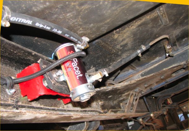

Upgraded to the Bosch/Facet electric fuel pump.... mounted under the inside frame rail next to the fuel tank.
I retained the original mechanical fuel pump on the block for the appearance of originality but, I removed the operating lever that rides on the cam , used a flate block off plate between the pump & block & I put a block off plate in the top of the glass bowl {where the original rubber diaphram was }
I still use the top of the original mechanical glass bowl pump as an inline filter but the pump itself is not operational. { the original fuel lines & pump look stock when the hood is opened}
New electric Pump is run by a toggle switch under the dash { which doubles as a theft deterent}. I also added a small pilot light on the dash to remind me to shut the pump off.
The Facet pump operates at 4.5 to 5.5 GPM just like the old mechanical pump ,and it starts right up without alot of cranking even after the truck has sat for awhile & vapor lock problems are eliminated. It runs quiet & have had no problems with it at all. The Facet pump also has a built in removable & cleanable screen/filter.
May not be 100% correct but... no more worries about a $35 fuel pump ruining a $2000 motor whenever it feels like leaking into the crankcase.
This top quality Bosch/Facet pump will run you in the area of $175 retail each from NAPA but, I found a wholesale source at around $80 with free shipping here....
