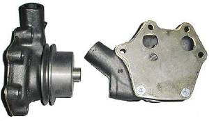

We have NEW short shaft water pumps for the 1955-1962
235 & 261 motors.
Complete with the proper pulley & gasket.
[Linked Image from i.ebayimg.com]

yes, that is a good picture MT. I take it that the short shaft is to fit the 53-54 truck or car narrow fan belt? And does it take the 55 and later fan blade? Will this pully give you the same fan speed as the 37-54 pully?
What is the cost shipping included, do you have to have a core, or is there a core charge?

These new short shaft water pumps will not fit the 1937-1954 motors.
These are designed to fit the 1955-1962 motors only.
This pump allows you to fit a later 1955-1962 235 motor in the 1937-1954 cars & trucks without having clearance problems with the fan blade & radiator.
No core needed. Uses the later 235 fan blade. 3/8" Pully is designed to move water & turn the fan blade at the same rate as the stock '55-'59 pump.
You can get'em here.....

yes, I meant to say the short shaft pump is made to use on a 57 to 62 engine in a pre 55 Chevrolet car or truck with a 261 or a 235 engine.
