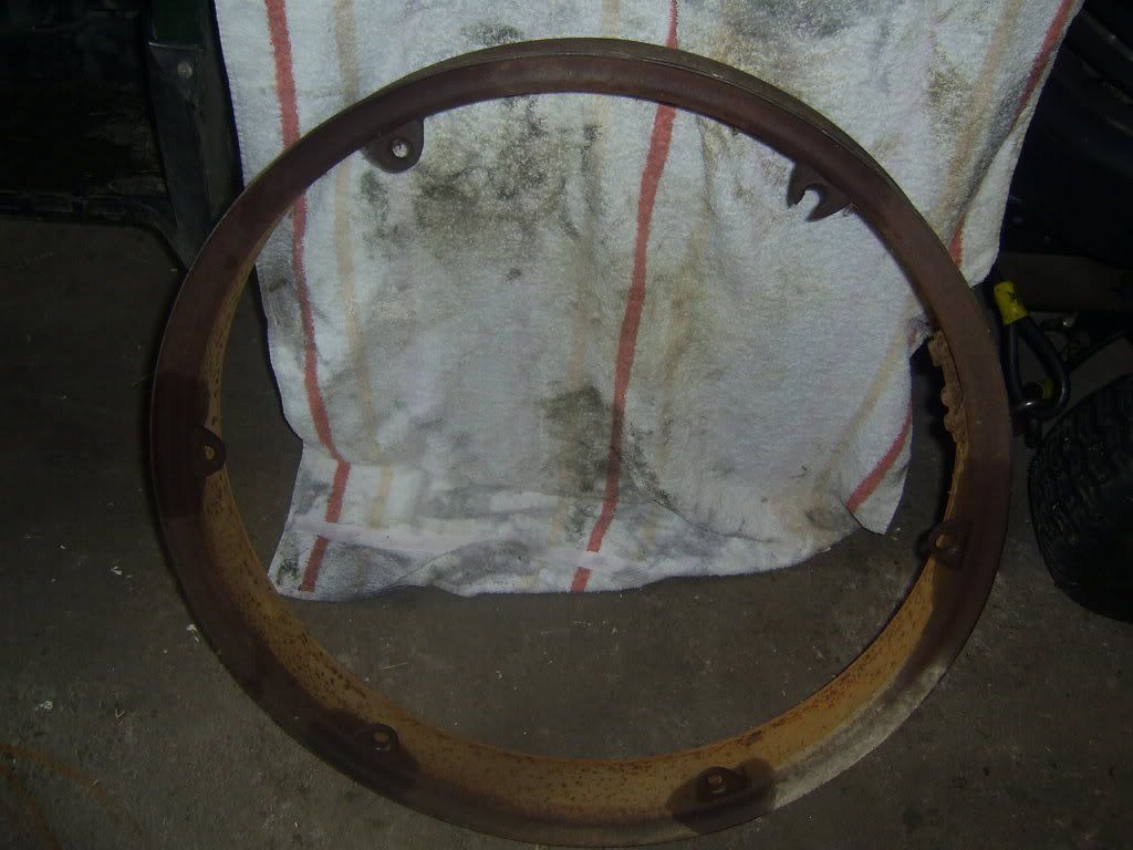

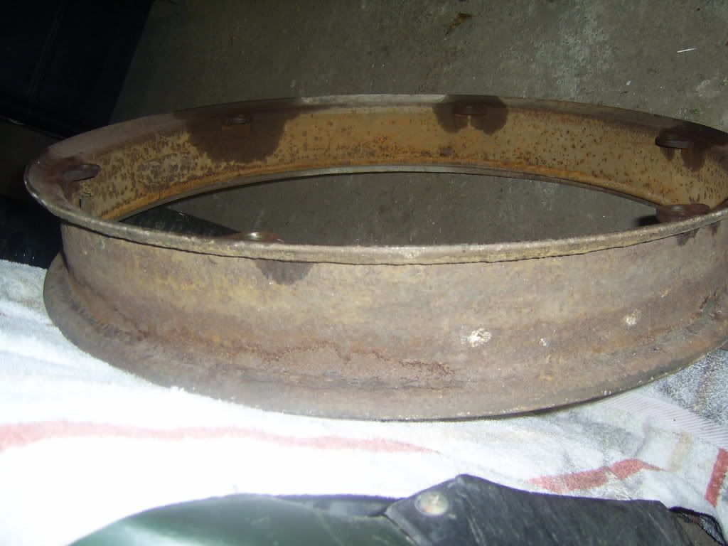

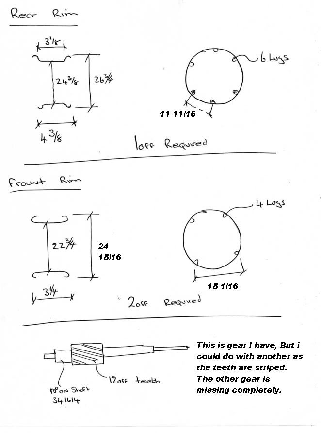

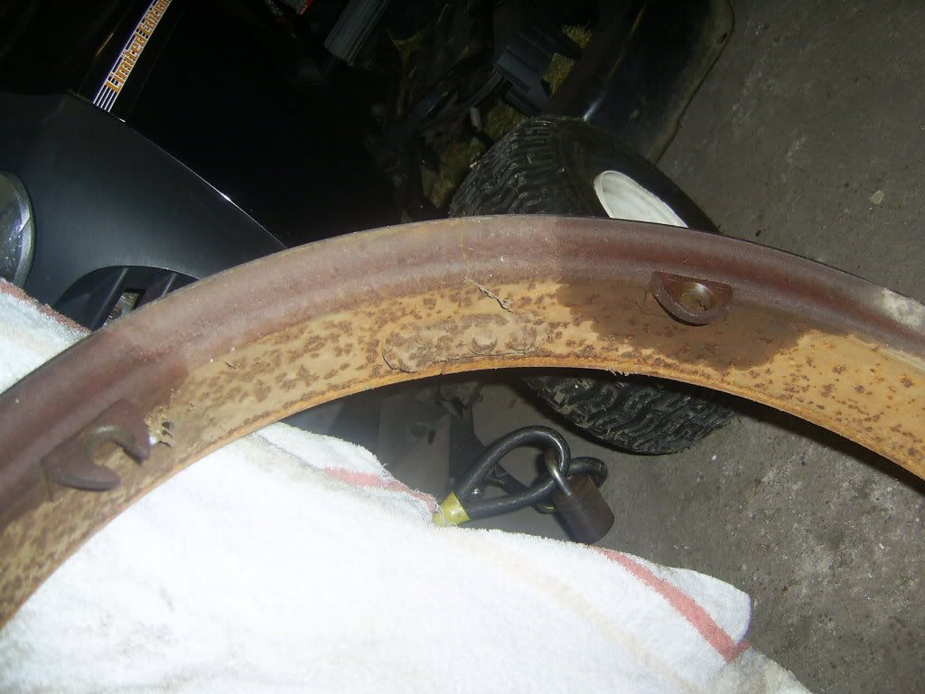

I am restoring a 1924 chevy 1 ton truck and need to locate
the steel rims the tyres fit onto
I am looking for 1 rear rim, 2 front rims.
The original ones have corroded where it had stood for years.
I have taken some photos and some sizes of the original ones.
the drawing with the sizes on please ignore the speedo gear at the bottom, its just something else i was working on.

When I couldn't find rims for the 1920 truck that I am restoring I had Coker tire make them. They have the dies for most rim profiles. Be prepared as they will be from 150 to 300 each.

I have also been told of another company Universrsal vintage rims (www.universaltire.com)
