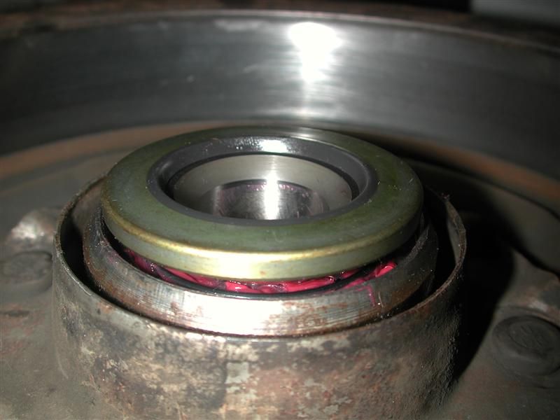

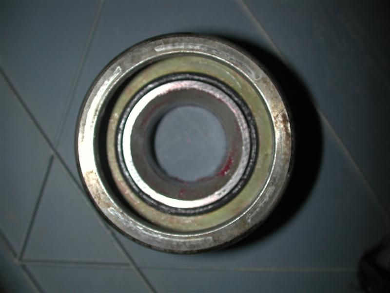

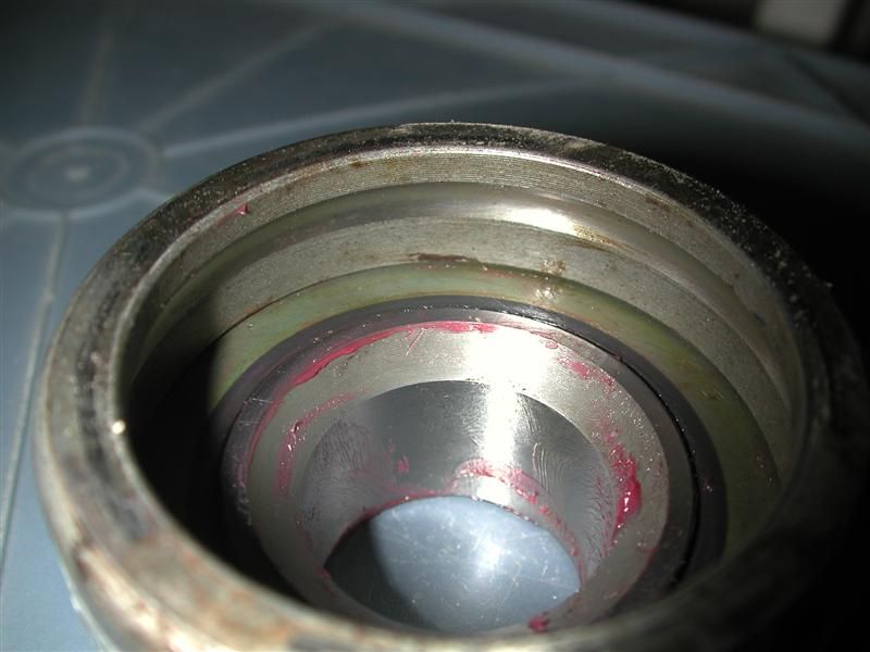

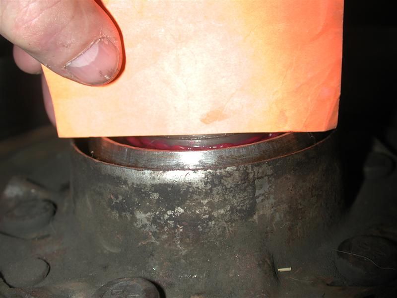

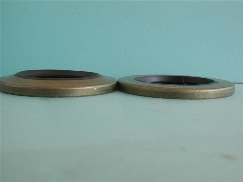

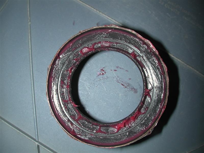

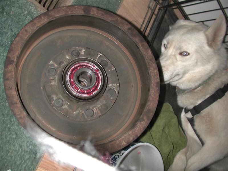

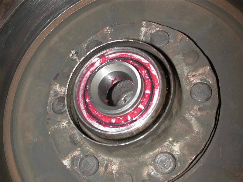

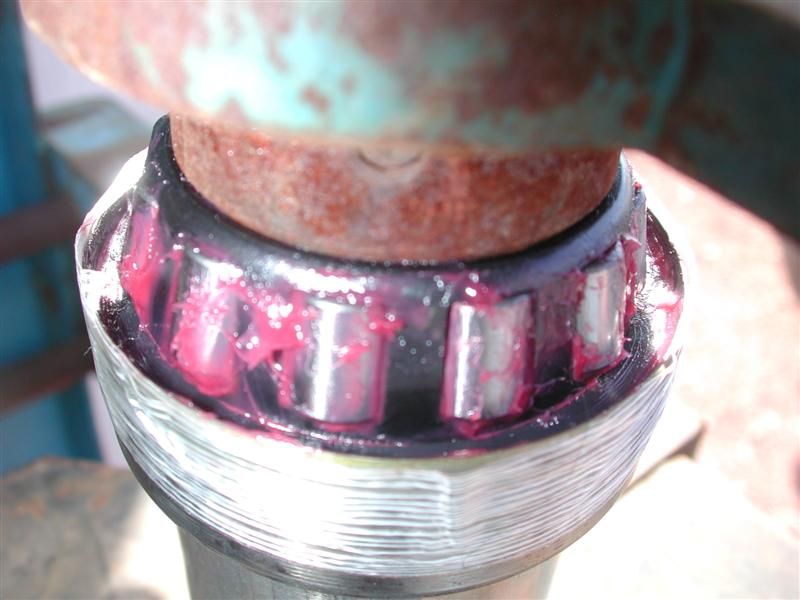

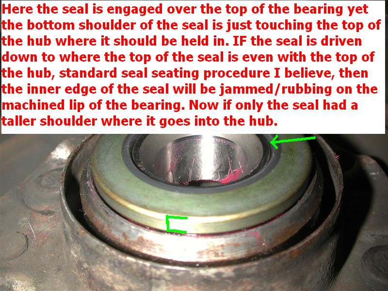

Here is some photo-documentation of bearing/seal situation. I hope these help explain the problem I'm up against.
[Linked Image from img.photobucket.com]
First make sure that you have the races and bearings in the correct position. Next drive the seal in until it's flush with the hub. Put the wheel on and see it it will turn. If it does, you're probably okay. If it doesn't turn freely, then knock the whole mess out, put a wire through all the parts and hang it up on your garage wall as a reminder that you should ask here (Chatter II) before you go off on half-cock trying to get modernized when there is no need to.

I understand that the original ball bearings are adequate for the 4T1. I figured that if a large company like "Chevsofthe40s" had a conversion kit it would be a positive upgrade to go with that conversion.
Yes, the races are pressed in to the machined stops in the hubs with a couple of ton pressure to make sure they were fully seated. There are only two sizes of bearings/races in the kit so there's no confusion there.
The situation is why, in this particular vehicle, the seals that come with the 'Chevsofthe40s' conversion kit do not install correctly. I think the pictures show what I'm dealing with. Certainly someone out there has done this conversion and has hands on working knowledge on the seal location issue I'm faced with.........?? I'm not inclined to give up and hang $183 on a wire when it's worked for many other folks.

Actually the seals were not "too thick". They just ended up being spaced at the wrong "deck height", if you will. I'm going off my past wheel seal installation protocol in that the top of the seal should seated down to the top of the hub that it's being seated into. What happened when installed that way is that the seal ended up being jammed against the raised up machined lip that is part of the one piece tapered roller bearing design(you can see that lip in the pictures.
Did they verify you had the right seals?
I ask them about it and they cross-checked that the seals that came with the kit were the same ones that they sell for the stock inner ball bearing wheel bearings.
What was their recommendation for installing seals?
This is where I was disappointed. The person I was directed to at C of F(great guy) to talk about my problem had never installed this kit into any vehicle(apparently nobody there has!!???). So he'd never actually looked over the parts and how they interrelated/fit together in the conversion kit. He did go and pull parts and look over what I was telling him my problem was. He did not see the pictures so quite possibly didn't understand the problem since he didn't have a hub with races installed to reference the assembly. He didn't know about where the seal was interfering with the machined lip on the bearing or how to deal with it. The only "solution" he had was to clean up the bearings/races/seals and send them back for a refund. Well I didn't see the sense in doing that as everything pressed in fine and the only problem was the seal interference.
d. Have you tried pounding on in flush to see what happens?
I did not want to do that as I could see that the only thing that would happen is the seal would be majorly jammed against the machined lip on the bearing.
e. Maybe the clearance is just enough so the bearing is not adversely affected by the seal.
I think it would be the other way around. The seal would be adversely affected by the bearing/lip on the bearing. There is not enough clearance.

The "coning" of the seal basically moves the sealing lip out on the bearing. There is .220" of smooth surface on the bearing, before it hits the machined lip (seen in the previous pictures), where the seal can locate and do it's job of sealing against the grease.
The "coning" of the seal does decrease the seal I.D. diameter which will create a slight increase in the seal edge pressure on the bearing. I'd MUCH rather have the increase in seal edge pressure vs. the seal being jammed in to the machined steel lip on the bearing. The very end of the bearing is what contacts the spindle. The seal is inboard of the end of the bearing. I'll have pictures later to illustrate.

Here are some pictures of the seal solution I came up with for the problem I was dealing with.
Here is a picture of the old ball bearing race I used for the pressing of the seal to cone it out for clearance.
Here is another view;
Here I taped the seal to the race to keep it centered during the pressing process.
The pressing process;
Here you can see a distinct ring where the outside of the tapered roller bearing race pressed into the rubber side of the seal to bend the steel part of the seal and cone it out.
Here is the end result;
I'd wanted to take a few pictures of the seals installed into the hub(s) however I got busy and didn't do it before I installed the front brake drum/hub assemblies.
Now I've got another problem that I'll be detailing in a new post.........it's always something with projects!! :-)
