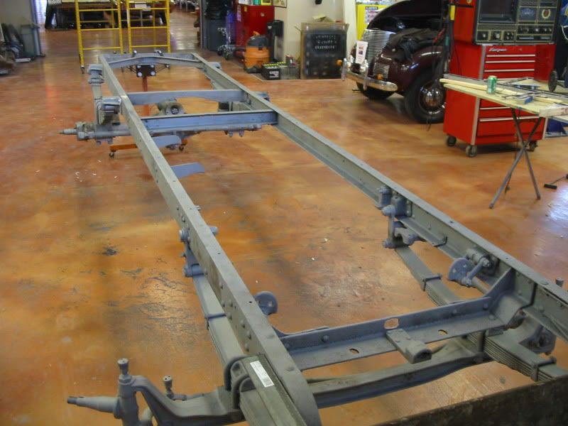

What would be the correct finish for the frame of a 1920 Model T Chevrolet truck? I assume black, but semi-gloss or glossy? What about rear end, springs and steering axle and components?
[Linked Image from i118.photobucket.com]
Its all together and I wouldn't take it much farther apart if I didn't have to.Thanks, Andy.
61 vert #159843 12/22/09 09:11 PM
The frames were dipped in a paint approximately the same quality and finish as generators and starters. The closest modern finish is semi-gloss or matte or ??? The rest of the parts should match. I would guess some parts were not painted or coated prior to or after assembly but have no documentation on what they might be. So coating all with the same finish is probably the safest.
