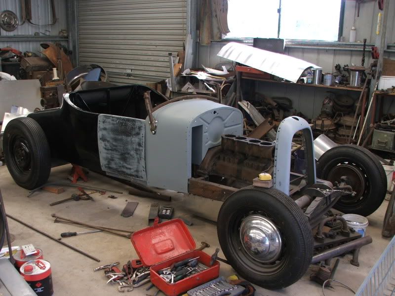

What did you end up with,? I'm starting on a 28 racer with twin SU carbies and would kill fir a 3 port head. I'm going with taller dished pistons to raise my compression. A 29 oil pump and an oil line to the main journals . Ray
