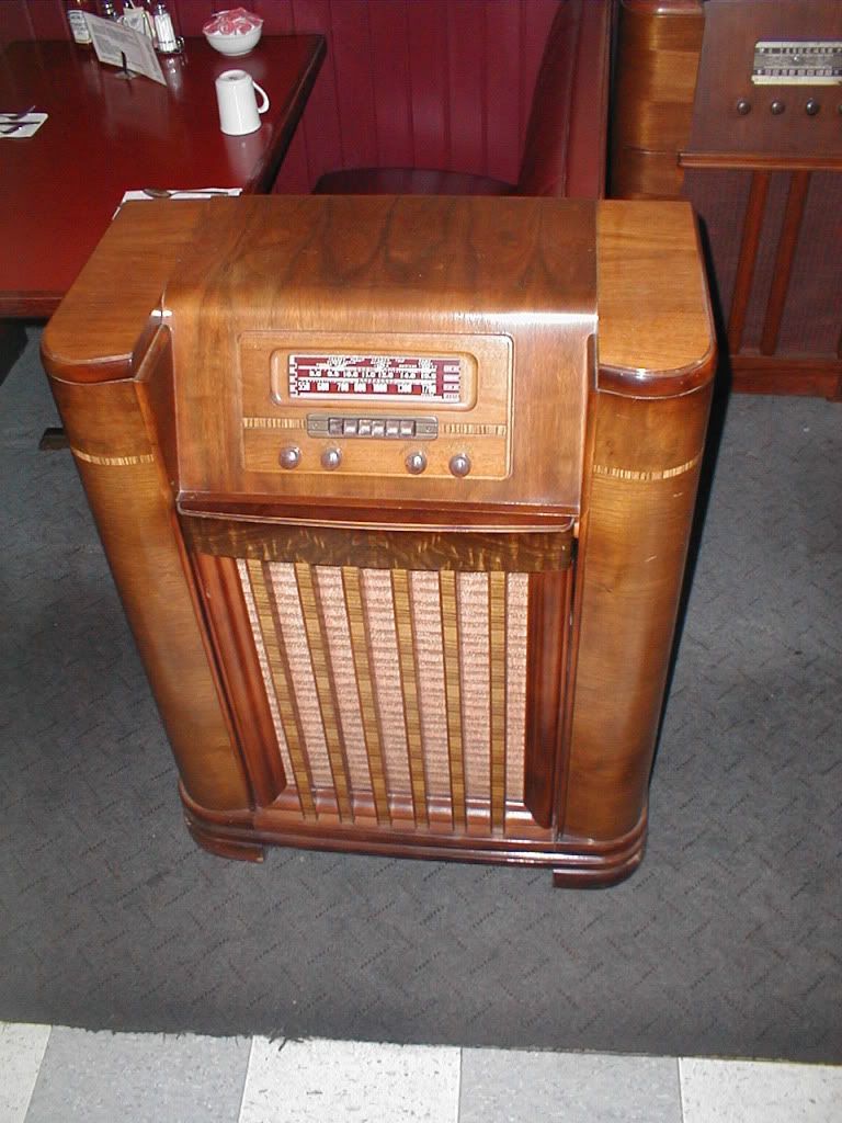

This was an early "CD Player" It has a photo-Optic Eye, that it uses along with the Needle, It bounces light off of the peaks and valleys in the Record Grooves. It uses those stupid LOCTAL Base tubes, and I haven't made adapters yet. I can't find the right Loctal Tubes, So I am gonna have to use Octal.

Ah, I see you have the disease also cookie. I've got a few of the BOL Philco’s, one of my favorites. The loctals are quite plentiful, have you tried AES in Arizona. www.tubesandmore.com? Also there are tons of tube vendors out there on the net and ebay and amazing as it may seem, tubes are still quite reasonable. In many cases not to much more than they were when new. DG

I generally have had good luck with World Tube Co. Except with Loctals. In the past I have always just destroyed the Bad Loctal, harvested its base, and adapted an Octal, when permissable. Unfortunatley, That particular Philco, doesn't have any suitable counterparts.
Ray, I am guessing you are implying you might have the proper tubes at your disposal? I will have to check the #'s. I put the project on hold, because of the frustration of finding Tubes.

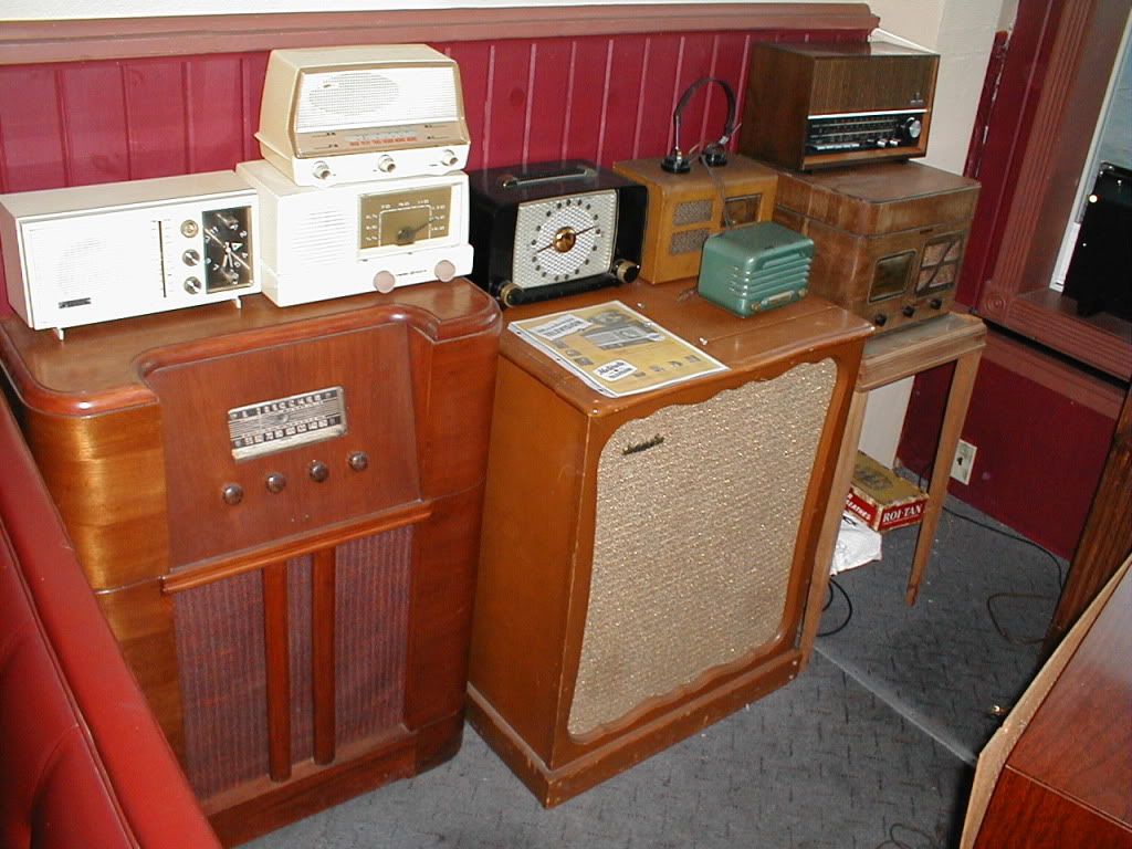

If you Noticed the TS-47 in the back ground, It was the very first "Portable TV" 7 inch Screen. That is the unit that I learned what a "Hot Chassis" meant. It is supposed to be Leather Bound, but, it was really bad. It had been sitting in a barn for years. I decided to strip it, sand it, and varnish it to match most of my decore around here. That TV actually transforms into a suitcase. Speaking of transformers, it hasn't got one. All the tubes are strung together, in addition to a big set of ballast resistors, to equal 110v. So if one tube stops heating. They all stop heating. Still a classic example of Immediate postwar USA.

I run them daily in the restaurant. I will either run Vintage Commercials on the TV's or Perry Como, Glenn Miller, or Herb Alpert sorta stuff on the Radio's. Pretty Neat Really. It occupies the mind whilst people wait for thier dinner.

You have some very nicely restored electronics there. Tony

Thank you, most of them are originals, minus some tubes & caps. The Motorola TV's use a Fuse/resistor. It is kind of a joke, Cause they don't make them anymore. I have 2 on my shelf, but, when they go, thats it! I would have to comeup with something else that does the same trick.
