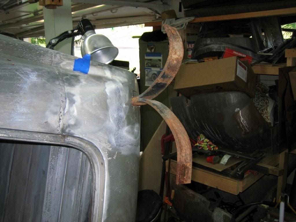

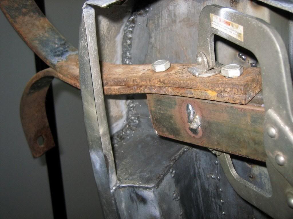

Lou; I have my 38 on a rotisserie and have a fairly light weight mock up frame under it for placement of all the floor and rear bumpers. Last weekend I cut the hole for the right bumper bracket. I will enlarge the hole later. I decided to shorten the tool well on both sides to eliminate the necessary water sealing problems with running the bracket through the tool well. Not stock but with all the rust repair I have done  it is my better choice  Hope these pictures help? Doug ![[Linked Image from i204.photobucket.com]](http://i204.photobucket.com/albums/bb124/nickeltree95/BumperBracketRR001.jpg) [/img] ![[Linked Image from i204.photobucket.com]](http://i204.photobucket.com/albums/bb124/nickeltree95/BumperBracketRR003.jpg)
