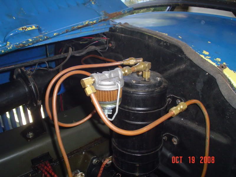

I would check for fuel flow at the carb and also from the main tank. Pull off line and slip on a rubber hose that fits and let it syphon. do that for both the vac tank and the main tank. It should flow a stream the size of the tube for a long time from the main tank and till the vac tank emptys. You could have some crud in a line that doesn't let the full amount through, or a kink in a line and possibly crud build up at the kinked spot, BUT if you say it isn't backfiring at the carb then a lean condition right before it dies may not be the problem. Listen to it real close as it may be hard to hear it backfire at the carb at that speed and may be just a light pop. I just say that because my hearing isn't what it used to be and it may just do it once at that speed before it dies, May help to have a good set of ears ride along if yours are like mine. Another possibility, Weak spark. A weak coil may not have enough juice to jump the gap when the cyl pressure is higher. Remember air is an insulator and high cyl pressures with throttle open = more air, more air = higher resistance. Another possibility is if you have the small diameter vac tank, not the fat one like on some 28s but the skinny stewart tank there was a special fitting used where the vac line goes into the intake that had a tube that went down a couple inches into the air stream from the carb. Might be something to look at but I would think vacuum is vacuum and the tank would still pick up the gas. Anyway Chevy did put those in some cars with the skinny tanks for some reason. For another reason they didn't use them in cars with the fat tanks. You might also fill the vac tank and then hook up a vac gauge to the fitting that goes to the main tank and see if it is pulling vacuum good. It should pull about the same as it will at the intake fitting! What ever the problem is you sure will feel good when you find it! My 24 Olds ran like crud for 9 years and the problem turned out to be a weak coil and the wrong plugs in the engine. (Needed long reach plugs and it had short reach) It would start better with the coil change, And the plugs took care of the low power and rough idle and running. I didn't change either for all those years because they were new parts when I got the car. Just didn't think they were bad so I did everything else and nothing worked. Last year at the Newport Hillclimb it ran 112 seconds, This year with only the plug change it ran 59 seconds. Much better!

Mack, here's my sediment bowl.
