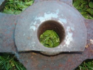

Well, I just made it cost alittle more money! I was working on getting the pressure plate and clutch off and broke a piece out where the carbon throw out goes... not good. Any ideas... buy a new pressure plate!

For sure you are in the market for an input shaft for the 1928 transmission. If you don't find a solution soon, send me a PM.
The radiator cap is an aftermarket unit. They came in different assemblies and were generic. The temperature unit has a bowtie; however it was made by Motor meter and not Chevrolet. Yours has a latch that opens the unit and you do not have to unscrew the cap.
Give us a picture of the part you broke on the clutch and one of us will have it.

Well here is the part I broke mad it is where the carbon piece makes contact. Anyone got one? [Linked Image from i47.photobucket.com]

The piece you broke is available as a reproduction from the Filling Station and likely also Gary Wallace.

What is the name of it? I would call it a pressure plate but I didn't see it on either ones web site?
David Baldwin
The Filling Station part number is AF-63, called Passenger & Truck throwout collar sleeve - replaces # 346809.
