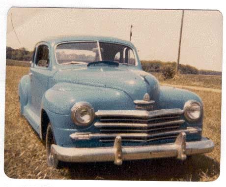

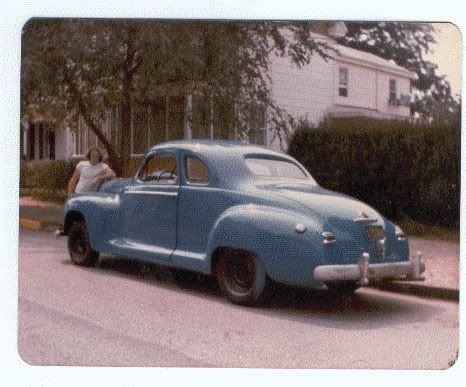

These are the only pictures I have of the Plymouth that are ready to be posted on line. Admittedly, they were taken in better days but she still wasn't far from that when I left her behind. She had been an almost daily driver the entire 33 years I owned her.
