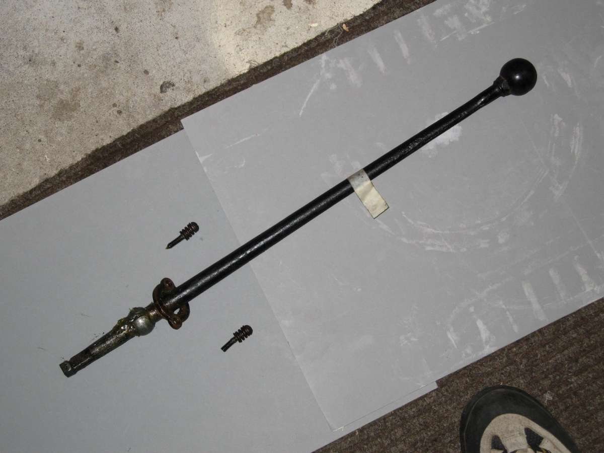

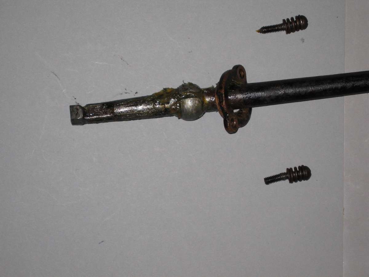

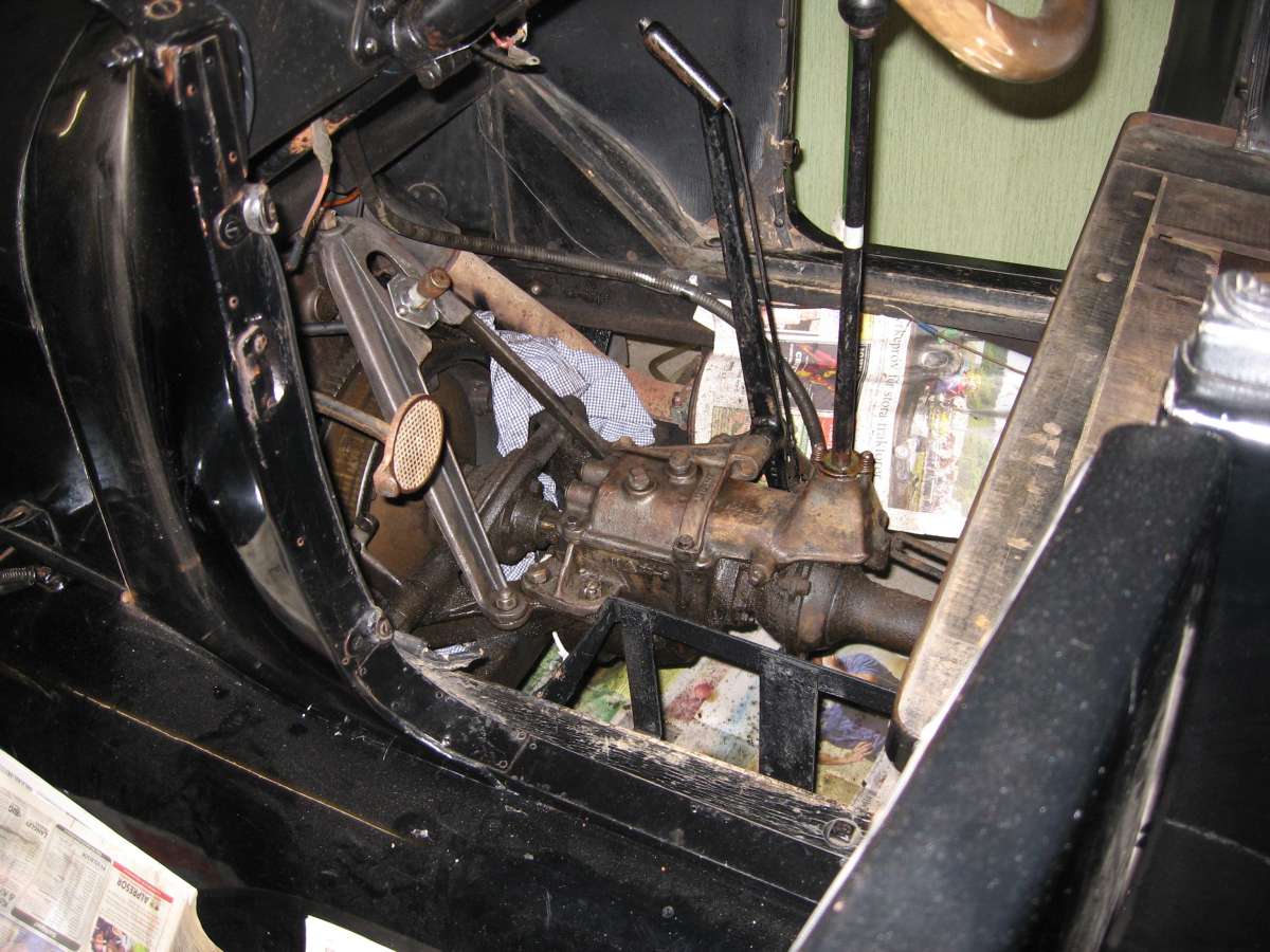

I think the 490's had a couple of different shapes of the shifter lever. See the attached pictures from my 1922, there you can see the "ball" on the end of the shift lever, where the lever goes into the rear part of the transmission lid, kind of a consol behind the transmission. See picture.
