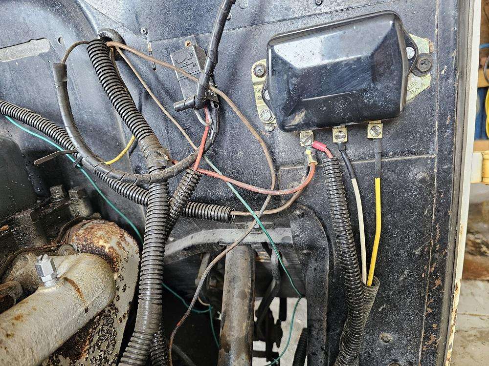

I haven't had chance to do much to my truck yet, because I don't really have a garage at our new (100-year-old) place yet, and there's 30" of snow here. And it's cold. haha.
But; I did get a new battery in it so I could fire her up and start to get a baseline.
For background; this is a '34 Chevy pickup. A previous owner converted it to 12v. It had a dead battery and, even with a jump was barely-running when it arrived to me a few weeks ago.
So now with the new battery in it, I fired it up and was trying to dial-in the ignition timing when I noticed the battery was spraying out both weep holes. I threw a multimeter on it and it's pegging >17v. !!!!!
There's an old voltage regulator on the firewall. No markings, but 3 terminals on the bottom of it.
Can somebody teach me how that regulator works, so I can understand how to test it? I mean, it's got to have a reference-voltage applied, right?

I recommend that you return your truck to its original 6 Volt configuration. Your life will be much simpler and there will be real wiring diagrams to follow. It's not hard or expensive to find an original style generator.

It might turn out easier and cheaper to revert to original 6v than diagnose and repair the 12v system you now have.
