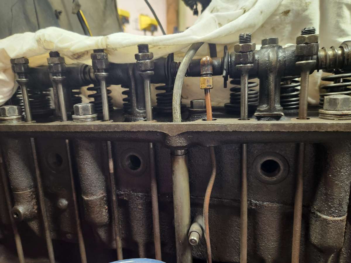

Why does my head not have screw holes on top to attach pushrod cover?

I could be wrong,
But it looks like you may have a head from an earlier engine.
The washers under the head bolts suggest something funny is going on there as well.
And some of your rocker arm adjusting screws are screwed out near the limit of their travel.
What number is cast into the head?

This is outside my expertise.
So can someone else verify...
Is that a date code on the head showing August 6, 1929?
And conveyor number 13?
