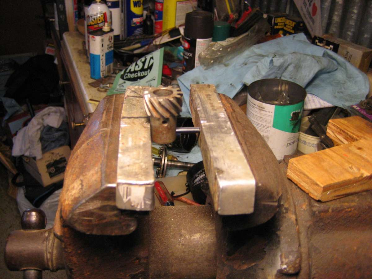

Photo 16 shows a long screwdriver in the distributor hole and me marking where it meets the clamp plate with a Sharpie pen. Photo 17 shows that the depth of the hole is 2.750 inches. Yes!! This measurement should work for all '26, '27, and '28 engines. Photo 18 shows the bottom roll pin being inserted into the distributor gear.

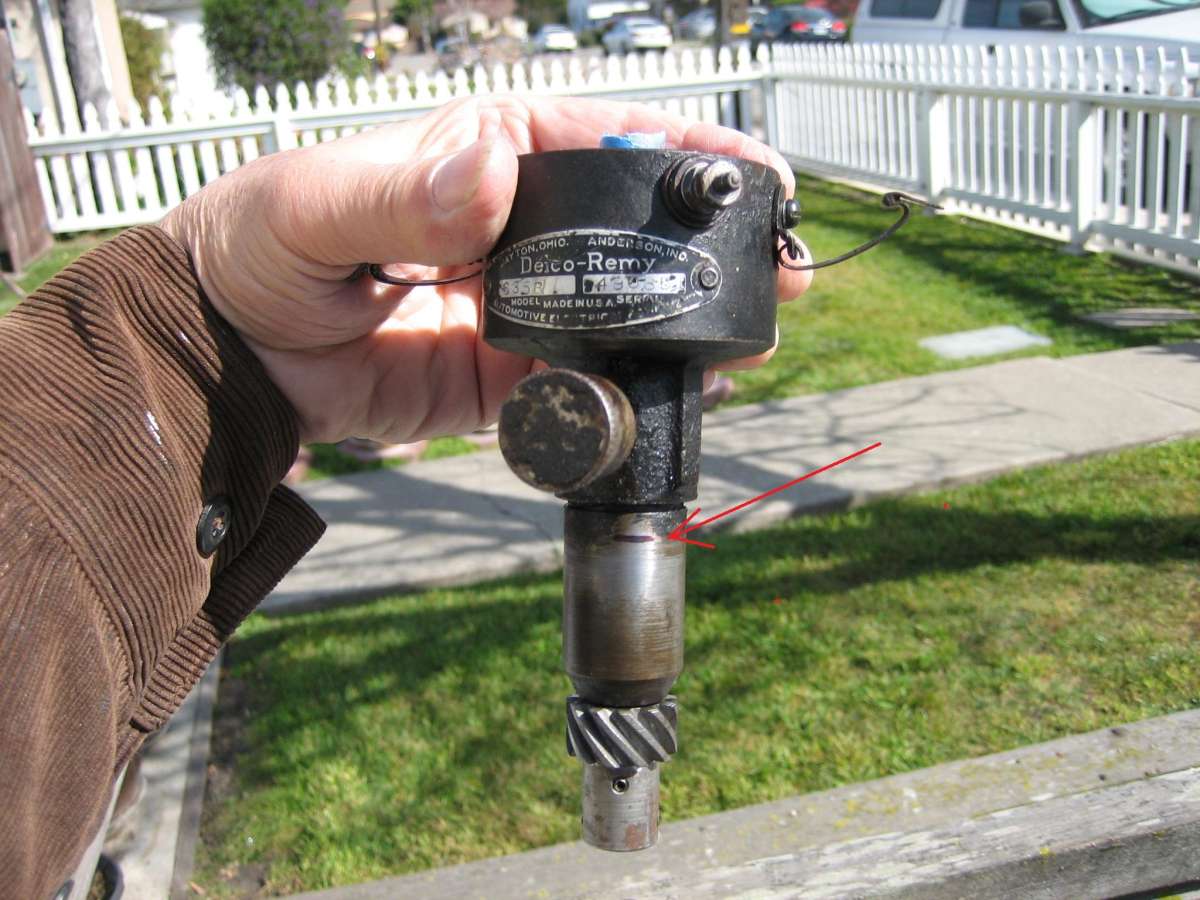

Photo 19 shows the hole-depth-indicating mark I made on the side of the distributor. Building upon the flat washer experiment above, I put a small strip of paint masking tape on the top of the distributor shaft to show me the orientation of the bottom pin in the distributor gear. This is shown in photo 20.

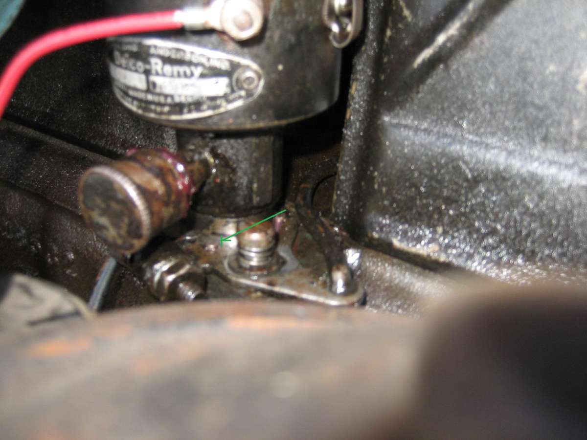

Photo 21 shows the distributor in its hole, but NOT aligned properly with the oil pump shaft slot. As you can see in the photo, the hole-depth-indicating mark is about 3/8 of an inch above the clamping plate. That is proof positive that the distributor is NOT FULLY SEATED AND IS NOT IN THE OIL PUMP SHAFT SLOT.

After correctly orientating the oil pump shaft slot, I dropped the distributor into its hole and (YAY!!) the hole-depth-indicating mark has dropped further down and is now close to the clamping plate. See photo 22.

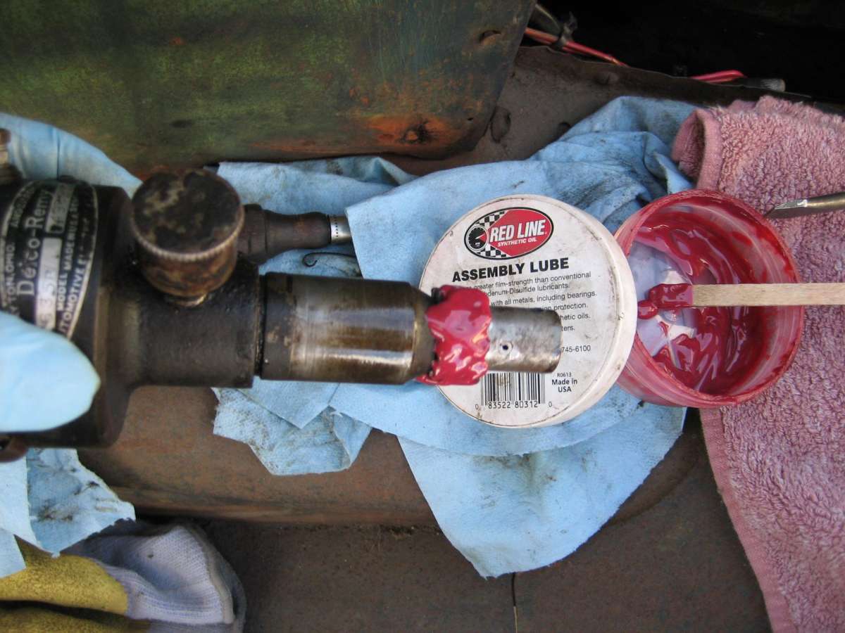

Now I am confident that I can positively determine if the distributor is fully seated and fully engaged with the oil pump shaft slot. I pulled the distributor out again, put some assembly grease on the gear (photo 23), and dropped it in the hole for the last time (photo 24). I was careful not to get any assembly lube on the inside of the clamp plate hole.
