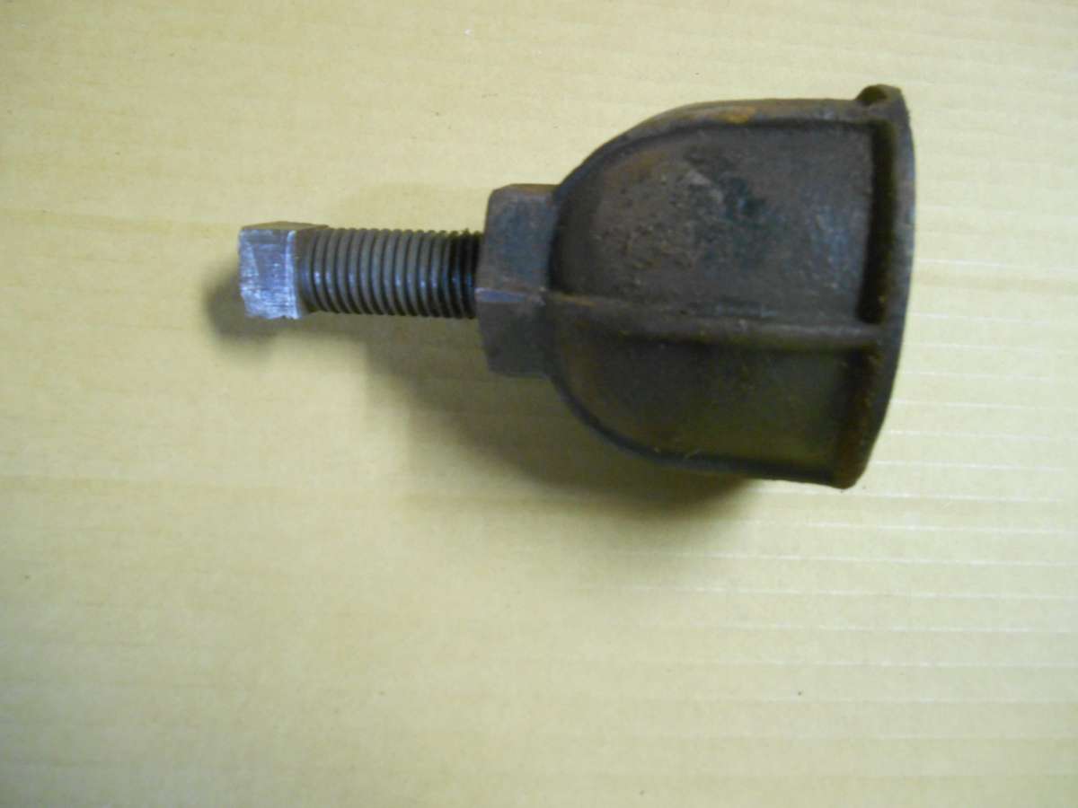

When I started working on my '28 Canopy Express, I couldn't use a regular wheel puller because the previous owner used a sledge hammer and smashed all the threads on the left rear hub.
Sooooooo, I made up the rig below to get the wheel off. I put spacers in the back so the pressure was close to the hub. I tightened the gear puller a fair amount and then whacked the gear puller bolt with a sledge hammer. After three or four whacks, the wheel popped off with a boing!! ;-)
P.S. Can you tell that I admire Rube Goldberg? ;-)
