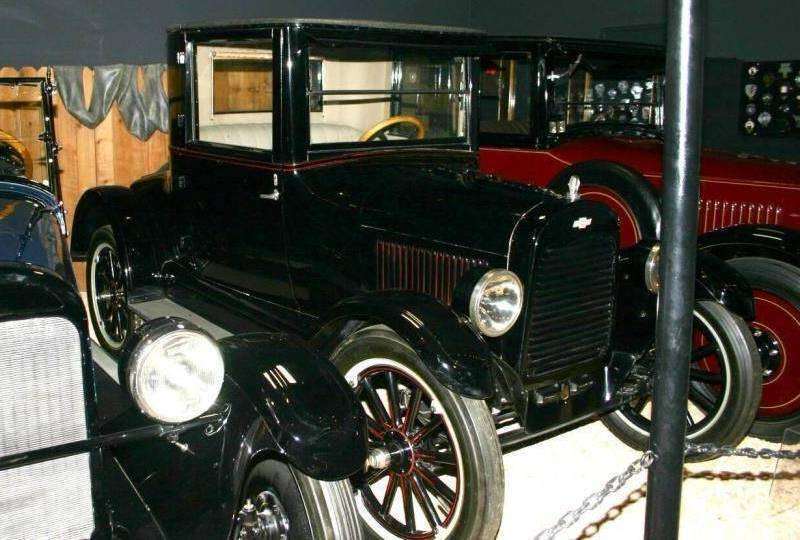

The third photo is the model D called the Utility Exp, not Superior.
The model D picture #3 was photographed at VCCA Kentucky meet
in August 2022. .

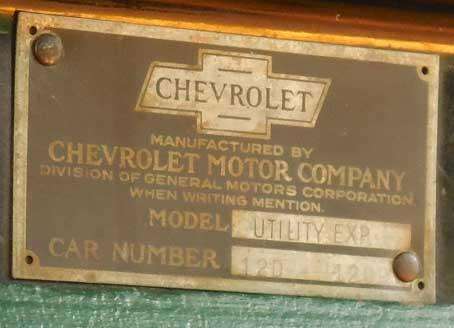

Fourth Photo is the model D's Vin plate. Most 1923 Vins
have no more than 5 numbers behind the letter. There have
been many Chevrolet model "D" over the years starting with
the 1917 V-8. Someone may have used a plate from a newer
vehicle in your car.

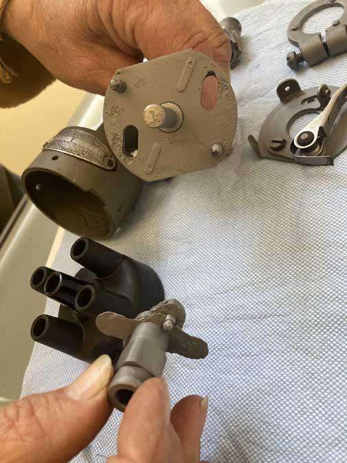

I took apart a 1927 ignition distributor and was surprised to
find a centrifugal advance inside. If the springs and weights
in your distributor are not in place, it could cause the symptoms
you describe. I assume you checked the firing order and plug
wires.
