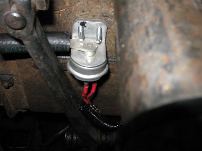

The only complicated thing about the lever switch is mounting it since there's no factory mounting provision. Other than that you simply run short wires from the lever switch to the wires that would normally connect to the pressure switch. FWIW I've read that the old Harley brake light switches were low pressure switches. They look identical to the stock Chevy switch. I have no clue if new repop HD switches would be any different from those sold for our cars or if the lower pressure claim is valid. I once had a 70 Harley with that type of switch and it worked great.

I ordered my lever switch from Rock Auto. It is the one they list for a 1949 Chevrolet pickup. It probably fits a lot of Chevy models over multiple years.
