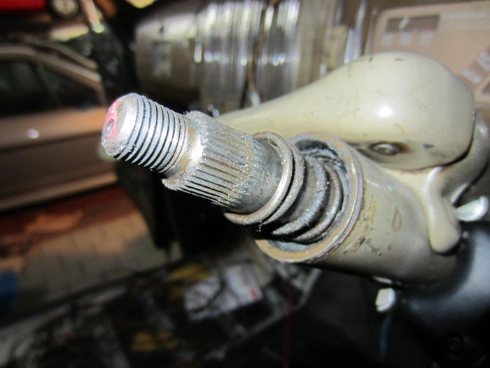

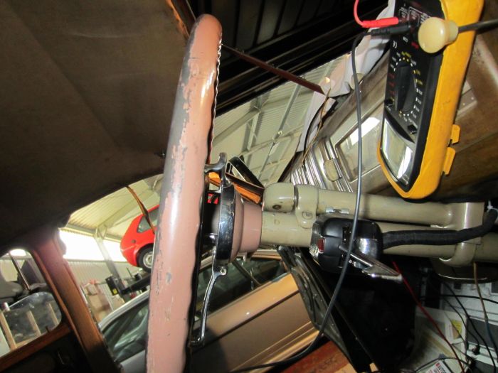

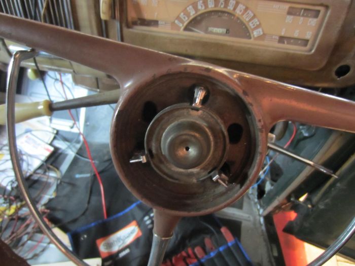

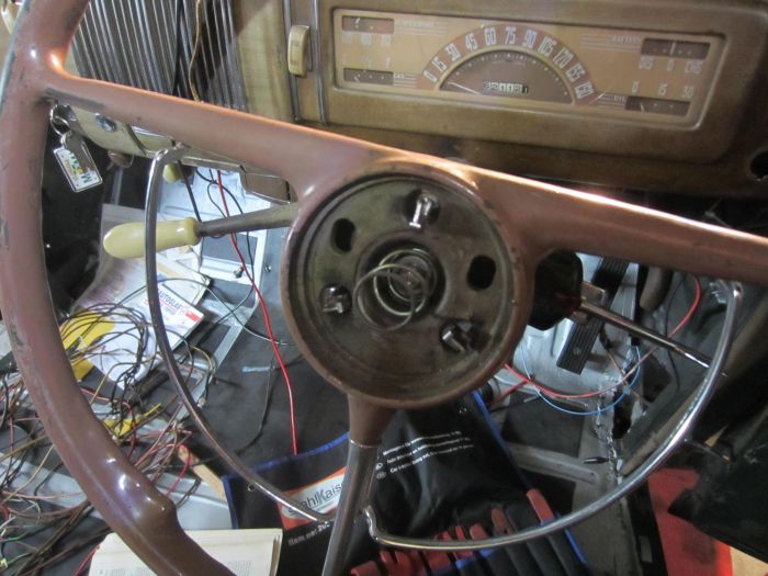

Also have a problem with my horn and came across this thread while searching
I replaced my broken de Luxe horn ring a while ago, but couldn't test it because the wiring harness was removed.
Now everything is wired again and the horns work even if I connect the relay, but not when i push the Ring. The error is in the ground of the
Horn ring
Can anyone tell me from the pictures what is wrong? The Distance of the Sleeve to the Steering Column seems to be much too big (Picture 4)? If I dismantle everything and let the horn ring rest on the column (Picture 5+6), then it honks. Or is there something missing?
Greetings André

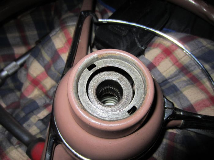

Could have solved this problem yesterday. After removing the steering wheel I also understood what is meant by "adjustable by turning the steering wheel lower hub housing".
The Hub Hoeusing has a thread and can be screwed down. Now the horn works in most cases when I press the ring. Still it looks like a part is missing?

Hi Andre'
Reinspect the bearing surface to make sure the surface is clean and has no rubber on top of the surface that could impede good metal contact. Your first picture shows the bearing surface not being perfectly clean. It can take just a small area of obstruction to stop the horn from sounding when pushing in one area while working fine when pushing in another. The design of my horn in 41 is different but the principles are the same. Check out my old posts to follow my journey to FINALLY getting my horn to work. Will try to update my pictures later.

Hello Mike,
As you said, today I cleaned the bearing surface and the ring on the steering wheel. Looks much better now ;-)
