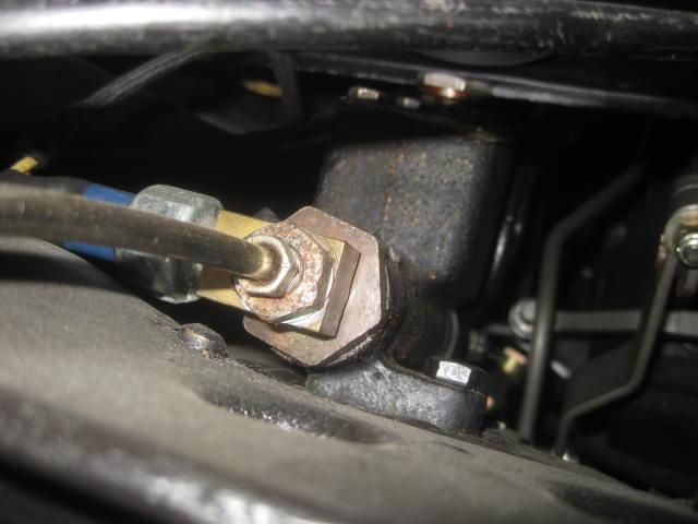

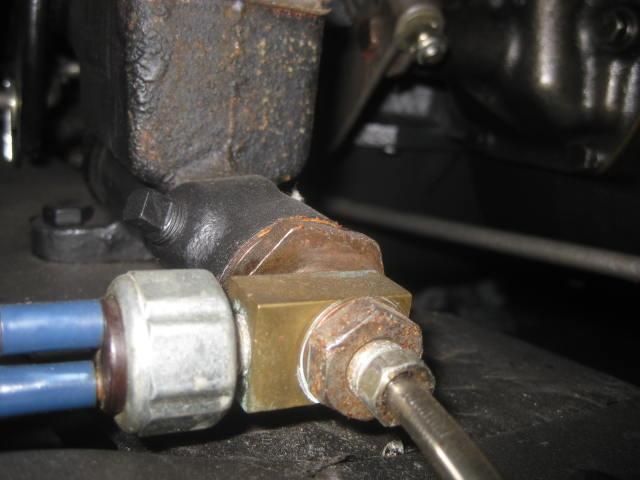

Hi Scott,
I have had some luck using a flare wrench by trying to tightening the fitting just like an 1/8 of an inch then trying to loosen it, this is after overnight soaking with a penetrant oil. If you are careful removing the brake lines I think you will find your brass fittings may not need replacing, just a good cleaning, and maybe a mild media blasting. I have attached pictures of my fittings, and their locations, including the one at the master cylinder. I do have extra fittings to sell if you find one that Chevs of the 40's doesn't handle.
Its not uncommon to end up having $800 in parts for a good brake job. It is also common to find that the steel lines can rust from the inside out because of moisture in the system so after all these years it is wise to change them. If you're not sure of the condition of the master cylinder it might be a good idea to take it apart and see whether it needs rebuilding or replacement. While at it your master cylinder serves as the mount for your brake and clutch pedals. Because of this you need to lubricate the parts that hold the pedals. Here are a few more pictures that cover this.
Good luck, Mike

Thanks Mike. A huge help as always. I saw pics of the block at the rear wheel cylinder, but I didn’t get that the bolt went thru it. I think I see a copper washer on both sides of the thru block?
And....if/when I get any junctions off. Degreaser then final rinse in brake fluid? Or brake cleaner?
yes on 2 copper washers, and yes on brake cleaner. Lots of fun ahead... Good luck.

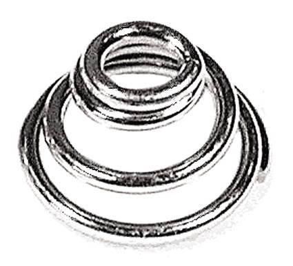

Question...is there a trick to get the shoe hold down springs on? That was the hardest part of my evening.

I use lacquer thinner for a lot of cleanup, "bad Mike?" There are tools for installing the brake spring, but the best tool is patience. Check out Youtube for help.

I'm talking about these springs and hooks.
Scott,
As to the shoe lateral holding springs shown above. It's kind of like "The Karate Kid" movie. Change wax on, wax off to twist on, twist off. Merely use a pair of pliers.
Don't buy anything that you don't really need. Only those things that can't be fixed. A twisted brake line is one of those things.
