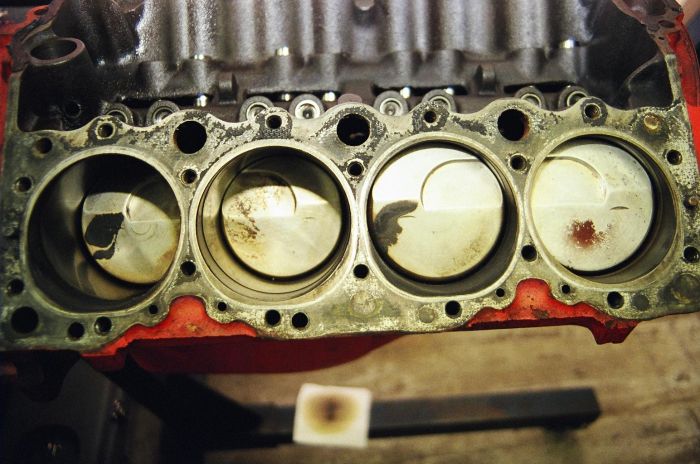

Do you mean like this Gene?
Due to an aftermarket cam and a timing set installed with the cam retarded 10degs, this one eventually took out #5 cylinder and required a sleeve. (not my doing).
Verne
When over reved the valve would float and hit the piston. This would knck the valve keepers off of the valve stem, the valve would "fall in" and the piston would break and the connecting rod poke ot the side of the block.
The same thing happened on 1957 283 engines with Power Pac. The solid lifter engines had valve reliefs cut into the top of te pistons to prevent this. All 283 engines in 1958 had the valve relief cuts after that. Seemed to happen only on stick shift engines as Power Glide owners did not tend to rev them up as high in manual low.
