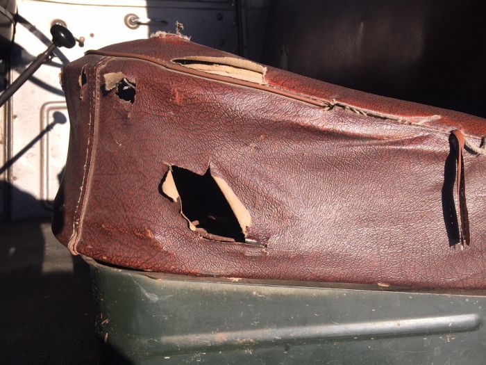

Okay, think we have the picture posting issue solved, so here goes...
Hi Mike
First... I didn't realize how ratty my seats looked until I took pictures!
Second, now that everybody can see the material, color, and sewing... are they original? The hair mat and cotton batting are both still there under the leatherette but getting a little worse for wear.
Third, I was wrong, the edge of the back rest is in 3 pieces and double sewn the same as the edge on the bottom cushion.
Hope this has helped.

Clement: "...I may be way off base here," I think you are probably completely on base here and I've wondered the same thing. And I don't think it's a dumb question at all, it's a very good one. I've also wondered why some cabs are painted crinkly brown inside while others like mine look like a marbled grey. Different day and different paint batch? Or different place of manufacture?
Rabaut: "does that mean my 1940 truck actually might have the original seats?" I would love to see pictures of your seats too. It really sounds to me like yours may well be original.
