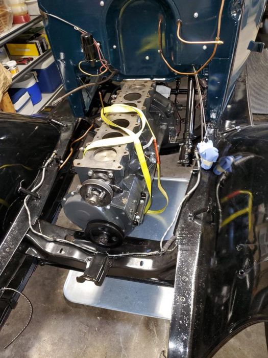

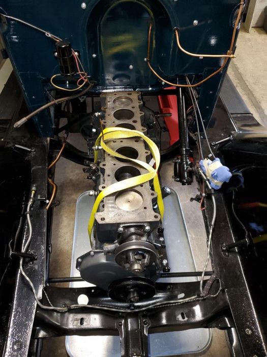

ok, tried to post these pictures last week, but the WiFi at the campground was horrible. (hey trying to keep up while hanging out after dark)
You can clearly see the difference in the cylinder walls, there is a clearly defined lip/ledge near the top where the rings do not run. the pistons are sloppy in the bores. do NOT have a mic to measure the inside, but will get the shop to do that for me later, once i pull the block.
you can also clearly see the scoring and pitting in the walls as well.Â

There is no doubt that it was NOT rebuilt at any time as it takes a lot of miles and running for the walls to wear and the top ridge to form. I know it's not what you wanted to do but when you are done I am sure it will be a first class job.

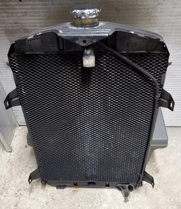

pulled the radiator core out the shell, and going to drop it off with the radiator shop tomorrow. they are going to give it a once over. flush it out good, check flow and such, then clean it up. figure while it is out again, will have it double checked and validated. the local shop here is one of 2 in the area that build and do custom radiators. been around since the 1940's they build custom radiators, heat exchangers, they are the ones that have the caustic tank that cleaned most of my sheet metal parts. old school shop, very nice people and have been good to me and fellow old car people around the region.Â

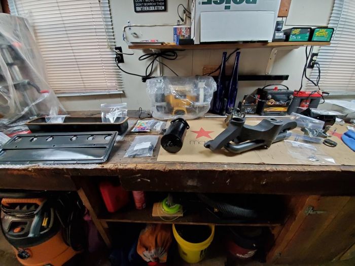

well spent a few hours in the garage today, stripping down motor and car to remove engine. attended our local AACA region Chili Cook off and hung out for a few hours there. then back home dinner and pulled the engine & Transmission. it is out of car and generally stripped down !!
did not take any pictures as i was working too hard and making sure i was doing things safely and correctly.
going to load it up and drop it at machine shop on monday. go over things to do and cost to do them. as well as timeline and time frame. once they get to the bore the cylinders i will KNOW piston size. hoping on .020 no more than .030 !!
maybe take some pictures tomorrow when i get out there once again.
