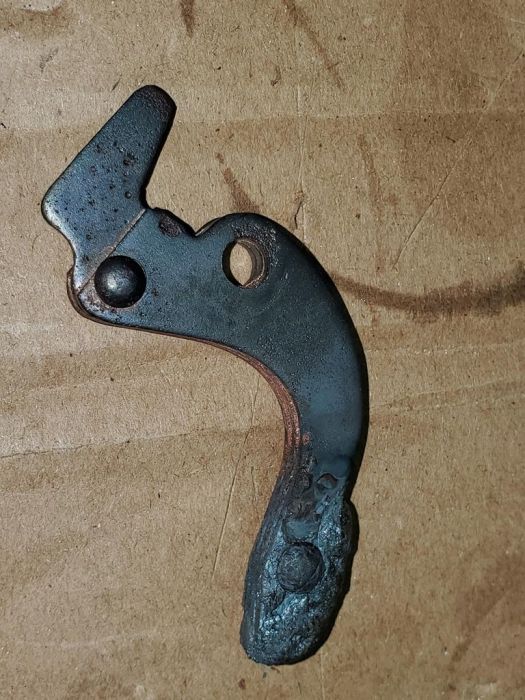

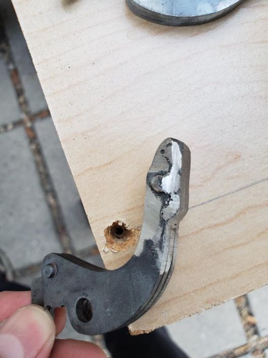

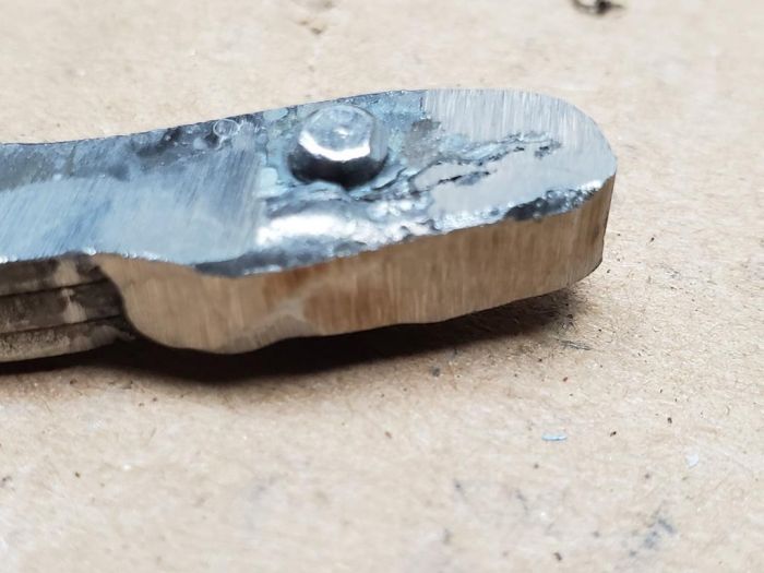

had some time tonight to work on the welded up fuel pump arm.
wire brushed it and cleaned it up and then set up my bench grinder and away we went.
too my time to try and keep the stock looking profile. after grinding ended up with a thickness of approx .390
