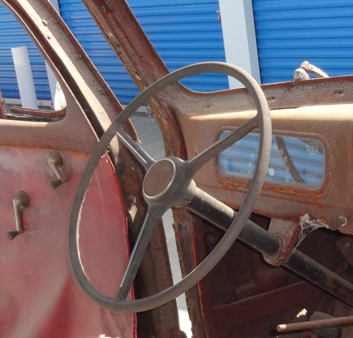

Is the steering wheel different between the master and master deluxe? If so what does a master deluxe look like
They both use a three spoke steering wheel. There is an accssory chrome spoke Banjo wheel available as an accessory.
A good one wil cost thousands of dollars today.
The Master weel has a slightly fatter rim but hey look about the same.

There was a "banjo" steering wheel, I don't know if it was standard on a MD or an accessory. I am sure some one will answer that question.
The standard Master wheel was quite plain and was used on many previous models.

For US cars, the 1937 Master Deluxe steering wheel also had stainless trim inset into the spokes of the wheel while the Master had plain spokes.
Here is a picture of a Master Deluxe wheel.

Ahh ok so the master deluxe steering wheels are the same as the holden built ones, and very similar to the 36's. thanks heaps everyone, would still like a confirmed list from anyone that knows all of the differences between a 37 master and a master deluxe if possible thanks :)

Steering wheel pictured is 1937 Master Deluxe and Cabroilet and painted black.

Were all 37 Master Deluxe steering wheels black, even if the steering column is brown?

All 1937 steering wheels, steering columns, etc. were black. 1938 was the first year to have them "colored"

Mine has a brown column and black wheel.. I have seen photos of others with the same combo. Built July 37

The steering wheel always was the same color as the column. In the later years (1942 and up) where the steering wheel was two colors the color of the steering wheel spokes (not the rim) matched the coloumn color.
The 1937 Master Deluxe used the new thinner rimmed steering wheel and was the only year/ model to have a thin stainless steel (or chrome) strips decorating the spokes.
The 1938 Engineering Manual states the the 1938 column was biege rather than the black used in 1937.
