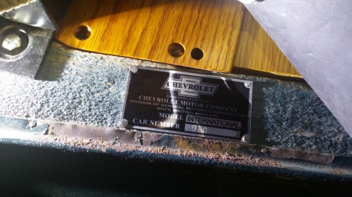

finally mounted the NEW data serial plate to the floor panel where the original one was installed
Where is the rest of the serial number??
Its there, just blurred it out :)
72xxx
These don't work for me. Canadian data plate is etched copper or brass and has General Motors Canada, International, serial number and engine number on it. I need to find someone who can etch me a blank plate. I have one but not from my car.
I purchased a blank plate and had it engraved by a jeweler.

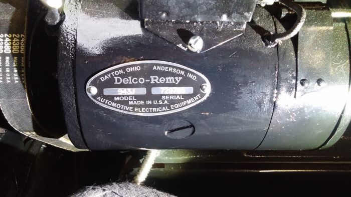

got the other tags/plates installed on the generator and distributor last night.
also installed the new Fisher Body Tag i got, used the rivet bolt kit from TFS worked great !!

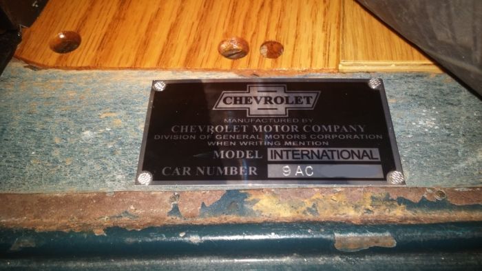

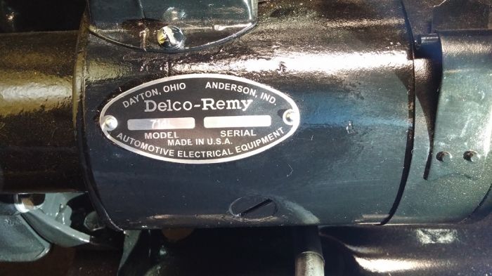

those wondering how good of a job AGBackeast did on my Fisher body tag, I'd say he did a superb job.
here is a comparison picture.
