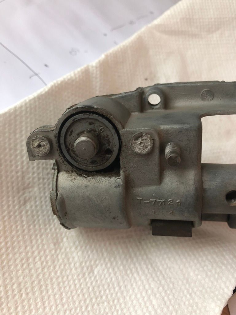

A follow-on. Attached is a a screenshot of my current regulator. [Linked Image from imageshack.com] The arrow points to the spot where the vent window "hinge" connects. It seems like the pot metal broke and allowed the vent window to move freely. I expect that the replacement regulator will have a "cup" that holds the hinge and there is a set screw to prevent the the window from turning without the regulator turning as well. I'm missing that set screw...assume I just go find something as short as possible that is the right size?

Hi Scott,
You should be able to reuse your regulator once you find the right size bolt (about 3/4" long standard thread). I recommend you soak the regulator in a small can of transmission fluid over night. After soaking it unscrew the screw applying tension to the swivel head. The transmission fluid will have loosened up the grease inside the regulator and lubricated all the moving parts. Let the regulator sit on a hand tissue for a day so the excess fluid can leak out.
Your picture shows that the shaft the vent handle is attached to is in good condition. A lot of regulator failures are caused by the shaft (made of steel) rusting so badly that the vent handle turns without moving the shaft as the vent is forced open or closed. Dried up grease lubricant can also make the vent hard to open and close causing damage.
When replacing the parts that put tension on the swivel its best to not tighten the screw very much to insure smooth easy movement of the window vent, and prevent ventilator damage.

So...I don't need the other side of the "cup" that goes up to the window?
The crank actually turns pretty easily and once I got the shaft back in alignment (out of over-travel) with the gears the mechanism works well.
I don't get why it was disconnected. No bolt was there. I just went and checked and the shaft coming down from the window was intact.
