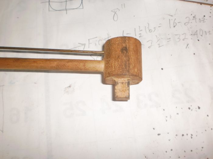

Here is what you need to set the resistance in your steering box.
It is a genuine, one-of-a-kind 0 to 300 ounce inch beam torque wrench. I made this over 30 years ago when I needed to adjust the steering gear on my '72 Corvette.
The head is a short piece of 1" wooden dowel that I cut a 3/8" square drive into. The "beam" is 1/4" dowel. The pointer is a coat hanger.
I calibrated it using 4 ounce fishing weights.
Works great for setting steering drag.
I measure the distance from the center of the steering wheel to the point where the shop manual shows the spring scale attached. I multiply that distance by the force the spring scale should read and the multiply by 16 to get ounce inches.
A few more pictures.

Would a fish scale work for this application ??
Yes, it would. The trick with any scale is keeping the line of pull perpendicular to the lever arm from the center of rotation.
The use of a scale also requires the steering wheel or some type of lever arm be installed. With this torque wrench you can set a steering gear using the nut on the shaft.
